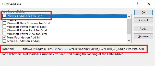

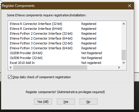

Hello, I have a different issue but also related with REGCOM.
I got a new pc at my new job. I don´t have admin rights. A colleague from IT tried to install Eviews (he has admin rights).
However, the COM Excel add-in was not properly registered. Even if we try with the commnand REGCOM command (with admin rights and Excel closed) nothing happens.
In my new job IT staff are not very acquuainted with Eviews installation, so I would like to ask for advice so as to identify the source of the problem.
Thanks!
Thanks!
Fede

Finally, you'll want to make sure the add-in is properly registered by EViews to work with Excel. You do that via the REGCOM command you already tried and clicking the "Yes(All)" button to re-register everything. As a suggestion, make sure Excel isn't running when you do this.
Afterwards, run Excel and if you don't see the Add Ins ribbon menu, then go to Excel File menu/Options then select "Add-ins" in the left list box. Select "COM Add-ins" in the Manage dropdown, then click Go. You should see the following dialog: Make sure the checkbox next to "EViews Add-In for Excel 2010" is checked. Also, look at the Location label at the bottom to verify that it's pointing to a location that is valid on your machine. If this label is invalid, you'll have to run REGCOM again. Let me know if you have trouble with this.
