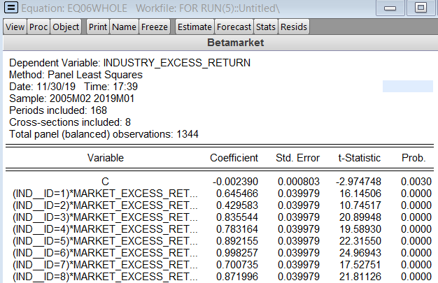

I have already estimated the equation with 8 crossid, and got the beta of X1 for each crossid, so I have 8 Beta.
I wonder if anyone can help me how to store those 8 Beta as a serie containing 8 Beta, since I have to use those 8 Beta to run another equation further.
Thank you in advance.
I am very new to eviews, and use only the equation box (cannot use the command area)
would be appreciate for your help so much.
2562-12-01 14_06_37-EViews.png (28.44 KiB) Viewed 7982 times

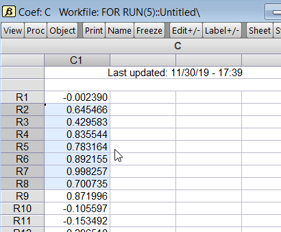

You will find the coefficients are automatically stored in the C vector. You can also find them in EQ06Whole.@coefs

Thank you so much. How can I use these Coefficient to run another equation further ?
In the below picture, I need to use data only R2 to R8 to run another equation, these data are currently in the C as the above post told..
Thank you so much.

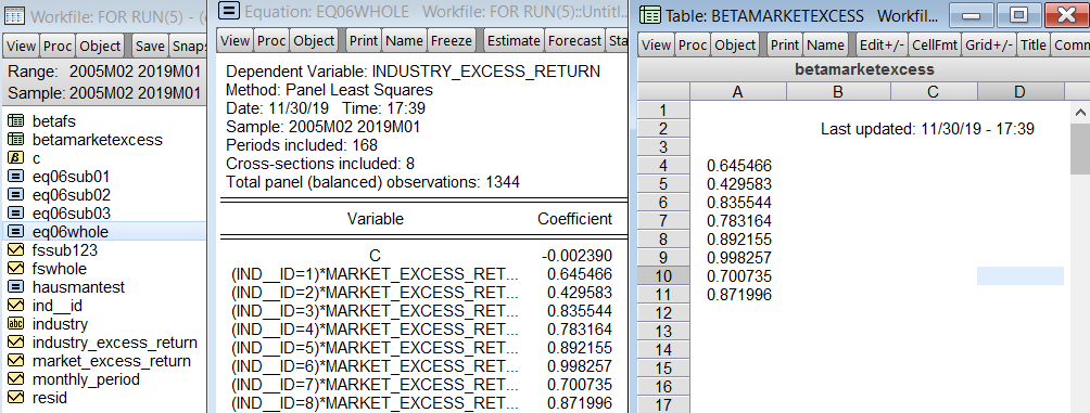

I try my best. To run the new equation that has to use input from the coefficient result from old equation, now I copy those 8 coefficients and edit, then save in new table. Not sure whether it is ok or not.

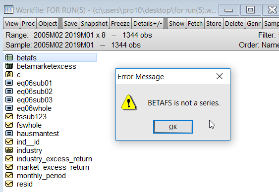

i tried to run the final equation but Eview said that my new input is not a serie, so I can't run the final equation. I don't know how to go further.
Re: how to store Slopes to run further equation
Postby EViews Gareth » Mon Dec 02, 2019 9:20 am
Create a new, empty, series (Object->New Object->Series), then copy the values into it.
