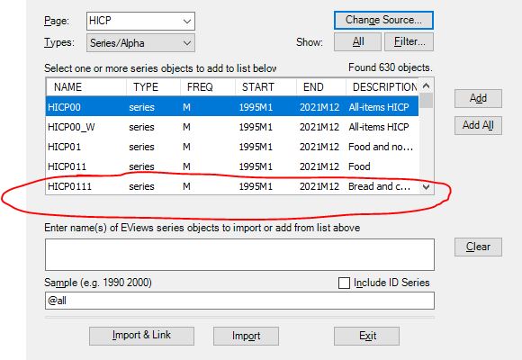

I have 2 suggestions to improve Excel Add-in for Eviews (I have Eviews 11)
1. Is it possible to import a description of the series along with series name into the EXCEL? Otherwise, once you have hundreds of series, it means series names are coded with short name and it's difficult to understand for other user in EXCEL what these series mean
e.g. it might be imported using the check box "include Description series"
2. Minor issue, is it possible to add horizontal scroll of the import data window, so that user can see a full description of the series?
Picture below - it's not possible to see full description
Andrei

Regarding your first request:
We could potentially include attributes as additional rows at the beginning or at the end of the data rows, but this can confuse Excel as it may decide your column data type based on the first few rows of data which now can be different data types.
Or maybe we could append the description to the series name?
As for your second suggestion:
We can add a horizontal scrollbar. We'll try to do this sometime soon.

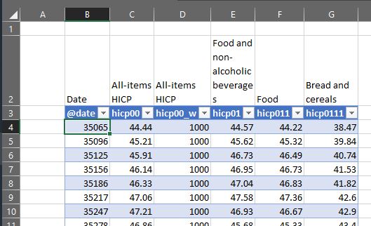

1/ Ideallly, I would expect a description to appear above the name of the series in the EXCEL (attached pic).
But, unfortunately, I have no clue on compatibility issues with EXCEL data type.
Appending description to the name of the series?! I think that users would prefer to keep names of series separate from description. I believe the Description of the series is very useful feature for end-users, which usually don't care about the names Eviews users exploit in programming...

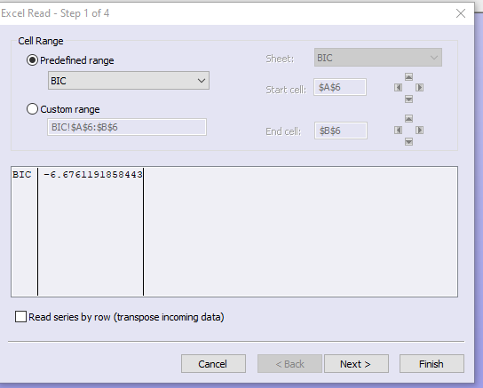

Does the checkbox (Open/Foreign data as workfile) at the bottom
Screenshot 2021-02-04 141050.png (14.65 KiB) Viewed 44698 times
do what you want?

Richard, Are you talking about importing data from excel to Eviews?
If anything, My question relates to importing data from Eviews databases to Excel by means of EXCEL Add-in
Re: Excel Add-in
Postby startz » Fri Feb 05, 2021 7:09 am
Sorry, I indeed misunderstood the direction.
