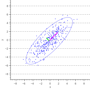

I want to create a 95% confidence ellipse over my x y scatter plot. Here is a reference visual:
I have not found anything in the eviews GUI, but perhaps there are some features I can use to help me.
If eviews doesn't have built-in support for confidence ellipses, where can I find the values for the pink and green lines in the confidence ellipse picture above? In other words, assuming I have a group comprised of the series: x,y -- how can I retrieve the eigenvectors of the covariance matrix for x & y?
Specifically, I'll need the eigenvector of the covariance matrix that corresponds to the largest eigenvalue (one for x and one for y). This will get me closer to computing the ellipse from scratch.

Two parts to the question.
First, you can add a confidence ellipse as a layer to the scatterplot. From the interface, click on the graph, and select the desired confidence ellipse in the Fit Line combo.
In command form
group grp1 x y grp1.scat cellipse
There are options for the computation of the ellipse.
http://www.eviews.com/help/helpintro.ht ... 23ww245664
There are some example commands.
As to the second part,
grp1.pcomp(eigval=eval, eigvec=evec)
will save the eigenvector and eigenvalues.
There are various options for the covariance and correlation computation.
