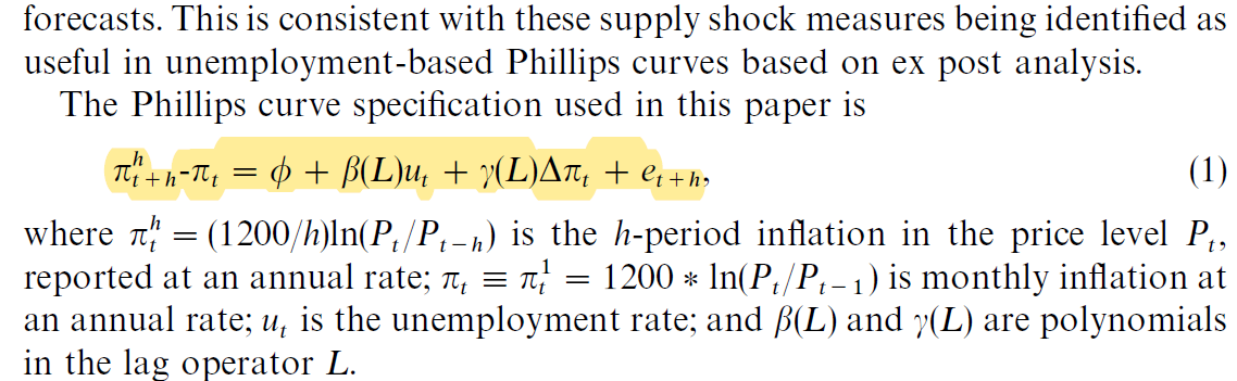

Hi everyone, i am estimating this equation. However, no matter how many Lags i give to any independent variables they will become not significant (look at p-value)

I've tried many many times only this 3 lags giving cpi_mr significant at 95%

Since the literature mention "the number of lags was permitted to be between 0 and 11"
Should I ignore the lag operator?
Re: forecasting
Postby startz » Thu Aug 08, 2019 6:09 am
Number of lags here means to use many lags, For example 3 would mean using x(-1) x(-2) and x(-3)
