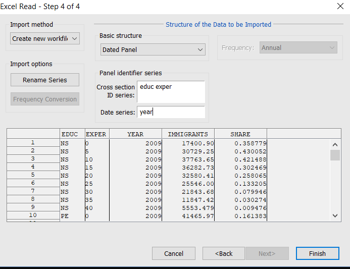

Hi, I have a dated panel with 2 cross-section series (exper and immigrants), but eViews doesn't allow me to use the fixed effects model when estimating...
This is an overview of the data I'm working with.

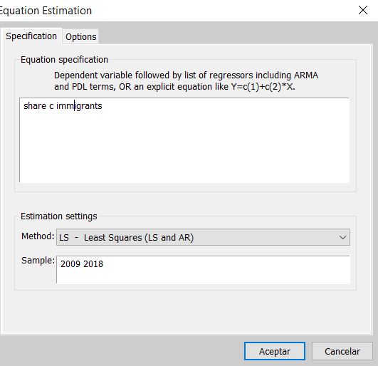

When I try to run the estimation, the "Panel Options" tab doesn't appear, and I don't know why since I loaded the data as a dated panel with two ID.
Could anyone help me to run the fixed-effects model with this data?

EViews only allows fixed effects estimation with 2D panels.
You could always create the dummies yourself using @expand.
