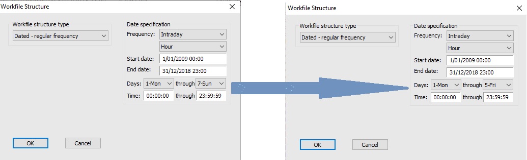

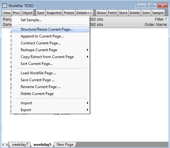

After some navigation through Eviews buttons I figured out how to do it.
If anyone is interested you just need to click "proc" - "Structure/Resize Current Page...". Then you just need to change the days to 1 till 5, and Eviews will automatically delete all observations of Saturday and Sunday.
Sem Título.jpg (62.24 KiB) Viewed 4490 times
Sem Título2.jpg (65.27 KiB) Viewed 4490 times
I hope I have helped some of you.
Yours sincerely
Afonso Rodrigues
