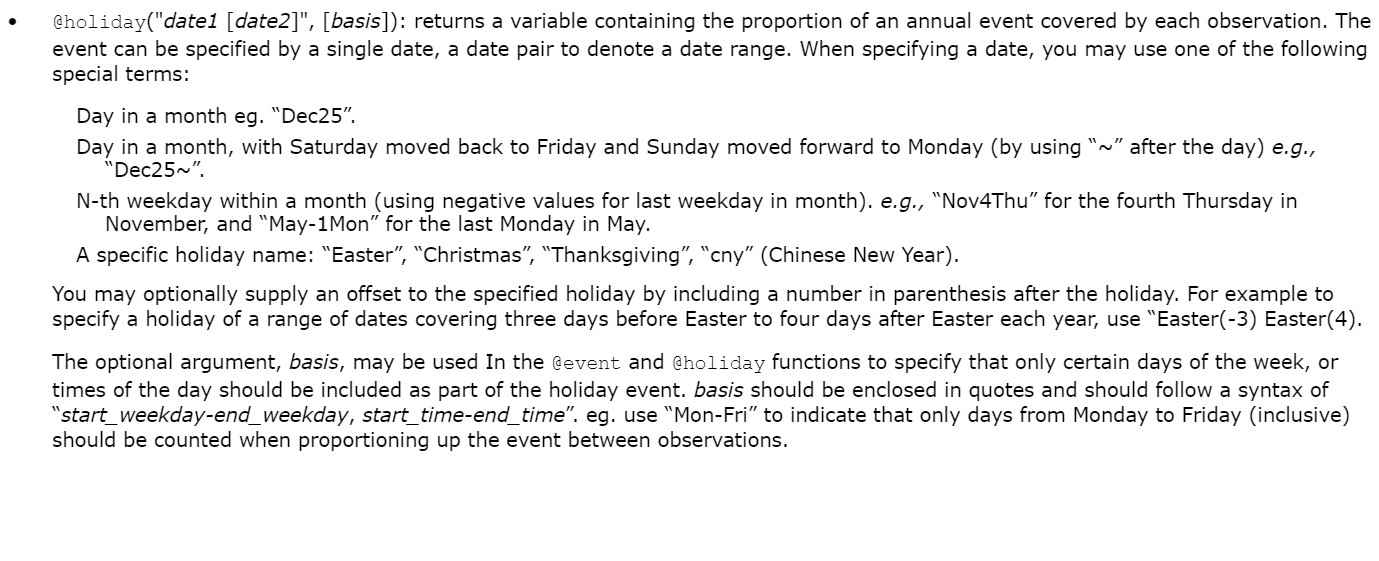

I noticed in this post there "are 4 holidays listed that are supported by @holiday. Christmas, Thanksgiving, Easter, and Chinese New Year. Just making sure I'm not missing any.
Thanks again!
Re: data manipulation using the @holiday command
Postby EViews Gareth » Fri Dec 18, 2020 1:51 pm
Correct
