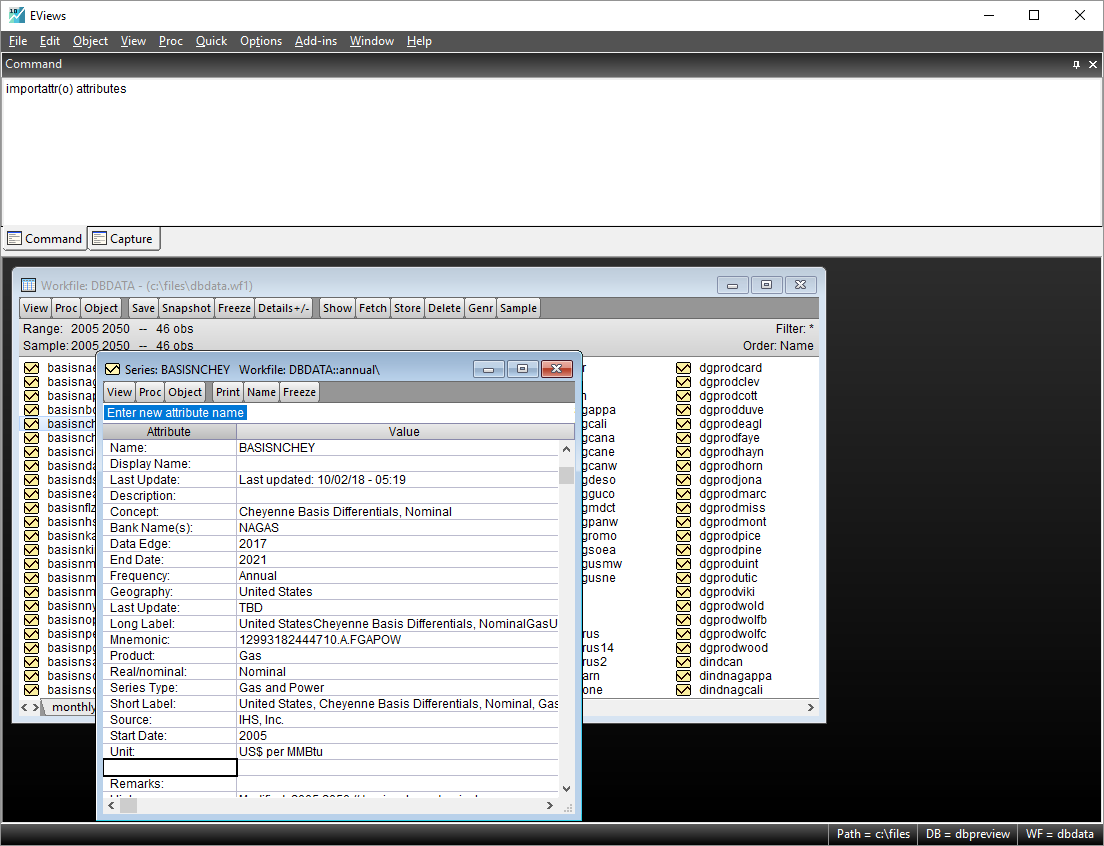

I downloaded your workfile, switched to the annual page, then ran the following command in the command window:
importattr(o) attributes
and when I checked a series on the annual page, it had all the attributes:
Is this what you're looking for?

That worked! Could you instruct me on how to remove the already existing "description" attribute from each series?

I wasn't viewing the series correctly to see the label. Once I changed that, it worked.
