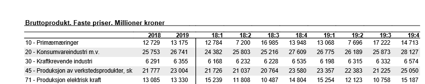

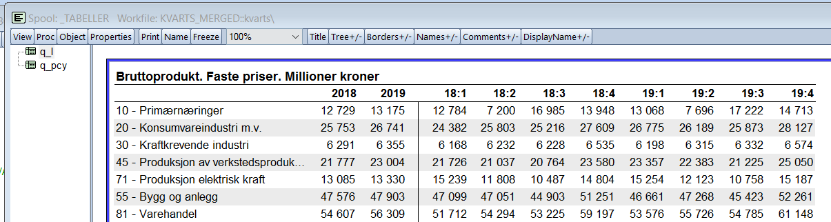

When exporting a spool with tables into a PDF a couple of things in the table change: firstly, an additional row with a line shows up under the header in the PDF. Secondly, formatting that applies to all the cells do not apply to the first two rows (header and years).

In the spool the first two lines looks like this:
In the pdf it comes out like this:
To make the print function was applied with: Microsoft Print to PDF on Ne01.

When the table was created, it was incorrectly configured internally by EViews.
What is the source of the table? Was the original source a group spreadsheet and a title was later added?
Can you post or send me directly (jason@eviews.com) the lines of code which created the _table_q_2018_l table.
