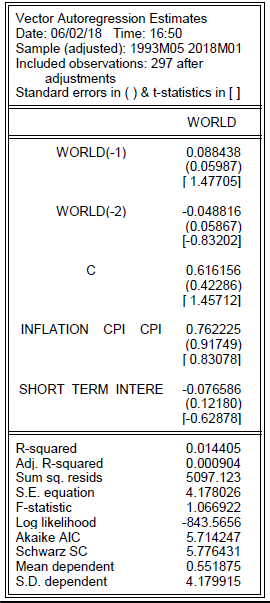

When I choose "Estimate VAR" in EViews, I choose the stock as the endogenous variable (in the following example it is the Index MSCI World) and the macroeconomic variables as the exogenous variables (in this case inflation rate and short-term interest rate). The results are as follows:
I did some research about VAR and know that it is usually provided in the format of a matrix. Unfortunately, I have problems to connect the values I receive from EViews and the standard formula:
How would the above formula look like if I incorporate the results from the first picture? What are the values for a(1,1), a(1,2) or a(2,1) and y(1) etc?
If the current macroeconomic variables are available, in the case of the OLS, I can simply insert the values for x, z and v to receive the value for y.
How does it work with an Vector Autoregression? Which part of the formula contains the macroeconomic variables (x, z and v respectively).Would I even receive one value or is the result a matrix? What would the matrix tell me?

A VAR is simply a set of OLS regressions of each endogenous variable on lags of all the endogenous variables and on the exogenous variables. Just enter in a couple of endogenous variables and you'll see what you get.

Is it correct that the equation for the Current MSCI World Variable would be as follows?
Y = 0,616156 + 0,088438 * Previous MSCI World (t-1) - 0,048816 * MSCI World (t-2) + 0,762225 * Current Inflation - 0,076586 * Current Short-term Interest
This would imply that the Variable World is dependend on itself, although its previous values. This is not true, though. Only the macroeconomic variables are dependend on the other variables, for example: Short-term Interest is also affected by inflation.
Does this mean, for my purpoe a VAR is not even the best choice?

To know whether a model is a standard VAR, you'll have to show what you want all the equations to look like.
