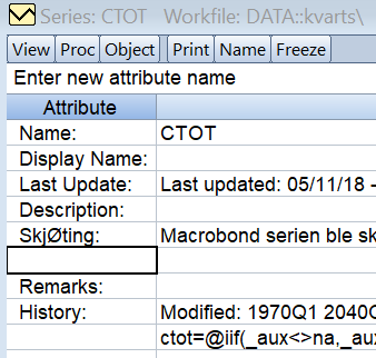

The command
.setattr("Skjøting")
yields a capital Ø instead of ø, see picture below

Interesting. I believe we are changing the case of the attribute name by making it Proper Case (which should only capitalize the first letter of each word), but maybe that algorithm is what's causing this.
I'll take a closer look on Monday.

This problem has been fixed. It'll be released in the next EViews 10 patch.
