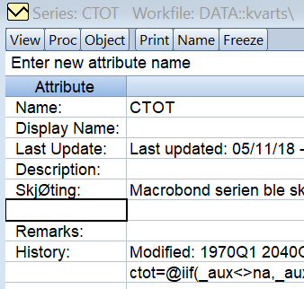

Postby tvonbrasch » Fri May 11, 2018 10:43 am
The command
.setattr("Skjøting")
yields a capital Ø instead of ø, see picture below
Re: Capital Ø instead of ø, in attribute
Postby EViews Steve » Sun May 13, 2018 6:17 am
Interesting. I believe we are changing the case of the attribute name by making it Proper Case (which should only capitalize the first letter of each word), but maybe that algorithm is what's causing this.
I'll take a closer look on Monday.
Postby EViews Steve » Mon May 14, 2018 7:57 am
This problem has been fixed. It'll be released in the next EViews 10 patch.
