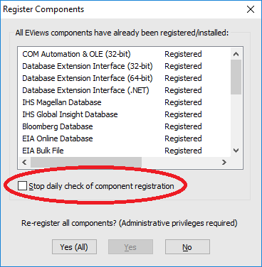

Many of our customers run EViews from a network file share especially when using a concurrent server license. Also, the appearance of the Register Components dialog is not licensing related - this check happens for all license types.
The Register Components dialog was designed for exactly this type of network installation where a user might be running EViews without having run our installer program (which performs the proper registrations for you at the end of the installation). So when EViews runs for the first time, it sees that there are components that are not registered on the local machine and displays the dialog. It does this check once a day the first time you run EViews.
If you wish to suppress the Register Components dialog from appearing again, you can click the "Stop daily check of component registration" checkbox on the Register Components dialog the first time it appears:
This setting is saved in the user's EViews32.ini file usually located in this directory:
%AppData%\IHS EViews\EViews\EViews32.ini
which usually resolves to:
C:\Users\<username>\AppData\Roaming\IHS EViews\EViews\EViews32.ini
If you open this file, and look for "Component Check v10=" for EViews 10 32-bit, or "Component Check v10 x64=" for EViews 10 64-bit, you can turn it off by setting both values to zero.

Thank you very much for your prompt response. I have tried pre-registration command in a test-workstation (opened cmd with elevated privileges) as provided in your former post but there are still unregistered components, so according to your comment I should rather send you a screenshot with all the components which are shown as "Not-Registered".
As far as suppress of the dialog box is concerned, I made necessary changes in the values in EViews32.ini file as per your guidance and the register components dialog box is not appearing in the first run of Eviews
