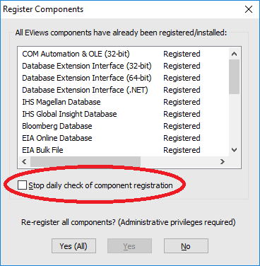

If you wish to suppress the Register Components dialog from appearing again, you can click the "Stop daily check of component registration" checkbox on the Register Components dialog the first time it appears: This setting is saved in the user's EViews32.ini file usually located in this directory:

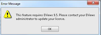

Furthermore, prior to sending an email to Eviews support, we would like to clarify another problem we are facing
Some of our users reported that when they open a specific workfile and they have selected panel regression with period random effect (with list square estimation) when selecting an equation and in the equation window View >> Residual Diagnostics >> Eteroskedasticity Tests the below error message is shown up and no test is being performed
Is it possible that this problem is related to the incomplete registration of part of the components or it is a totally different issue that should be also examined via Eviews support ??
Thanking you in advance
- eviews10_error
- Eviews10_Error.PNG (13.37 KiB) Viewed 30516 times
- Posts: 846
- Location: Irvine, CA
Re: Register Components
"This feature requires EViews 9.5" is a bug on our part. It will be fixed in the next EViews 10 patch, sometime this week.
