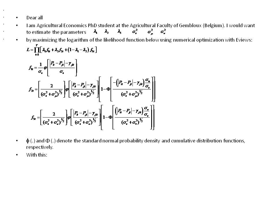

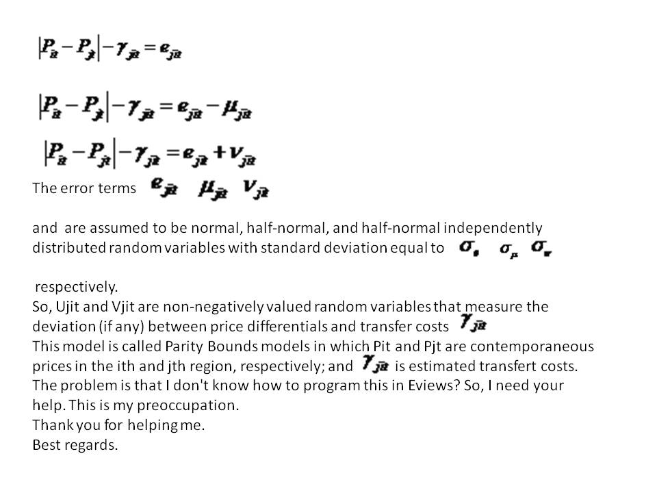

About my preoccupation on Maximum Likelihood Estimation, I know that my problem can be solved via building a constrained optimization model. The basic problem, for instance, is that the probabilities in my model must add up to 1. But I don't know how to build this king of contraints in Eviews. Mr Trubado helps me to have the following code I would want to share in order to have further help from moderators or other users in the forum. Thank you very much M. Trubado.
@logl agric
f1 = (1/@exp(c(3)/2))*@dnorm((ba-batc)/@exp(c(3)/2))
f2 = (2/@sqrt(exp(c(3))+@exp(c(4))))*@dnorm((ba-batc)/@sqrt(@exp(c(3))+@exp(c(4))))*(1-@cnorm(-(@exp(c(4)/2)/@exp(c(3)/2))*(ba-batc)/@sqrt(@exp(c(3))+@exp(c(4)))))
f3 = (2/@sqrt(@exp(c(3))+@exp(c(5))))*@dnorm((ba-batc)/@sqrt(@exp(c(3))+@exp(c(5))))*(1-@cnorm((@exp(c(5)/2)/@exp(c(3)/2))*(ba-batc)/@sqrt(@exp(c(3))+@exp(c(5)))))
agric = log(@logit(c(1))*f1+@logit(c(2))*f2+(1-@logit(c(1))-@logit(c(2)))*f3)
@param c(1) 0.1 c(2) 0.1 c(3) 10 c(4) 10 c(5) 10
NB. ba is the absolute value of the differnece prices between Bohicon (one region) and Azove (second region) and batc is the transfert costs.
Thank you for your help.
