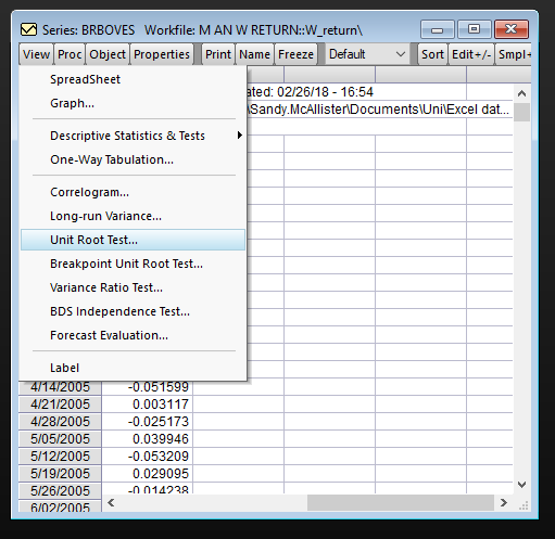

I'm using Eviews Student Version to analyse the data from 4 market indexes.
I'm running four statistical tests, Variance ratio, Unit Root, Runs test and Autocorrelation test to see if the data follows the random walk theory.
For the Autocorrelation test I'm analysing the log returns of each index. I'm looking at testing the data series in an alternative method to the Q-statistic and seen EViews can carry out the Lagrange Mulitplier (LM).
To carry out the test (as per this link: http://www.eviews.com/help/helpintro.ht ... stics.html) you need to push View/Residual Diagnostics/Serial Correlation LM Test. However when I select 'View', I do not get an option for 'Residual Diagnostics'
Sandy

Re: Runs Test Add-in
Posted: Wed Feb 28, 2018 1:25 pm
by startz
It might help Gareth if you could post screen shots.
Posted: Thu Mar 01, 2018 3:56 am
by sandy.93
Autocorrelation Screen Grab.PNG (25.24 KiB) Viewed 14475 times

Posted: Thu Mar 01, 2018 7:16 am
by startz
The LM test is conducted on residuals in an equation view, not on a series directly.
