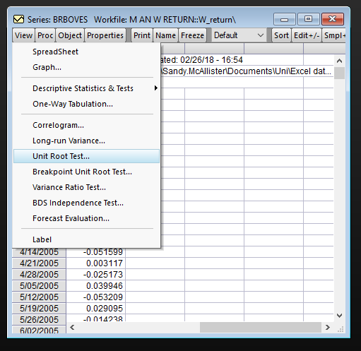

I'm using Eviews Student Version to analyse the data from 4 market indexes.
I'm running four statistical tests, Variance ratio, Unit Root, Runs test and Autocorrelation test to see if the data follows the random walk theory.
For the Autocorrelation test I'm analysing the log returns of each index. I'm looking at testing the data series in an alternative method to the Q-statistic and seen EViews can carry out the Lagrange Mulitplier (LM).
To carry out the test (as per this link: http://www.eviews.com/help/helpintro.ht ... stics.html) you need to push View/Residual Diagnostics/Serial Correlation LM Test. However when I select 'View', I do not get an option for 'Residual Diagnostics'
Sandy

Postby startz » Wed Feb 28, 2018 1:25 pm
It might help Gareth if you could post screen shots.

Postby sandy.93 » Thu Mar 01, 2018 3:56 am
Autocorrelation Screen Grab.PNG (25.24 KiB) Viewed 14461 times
Re: Runs Test Add-in
Postby startz » Thu Mar 01, 2018 7:16 am
The LM test is conducted on residuals in an equation view, not on a series directly.
