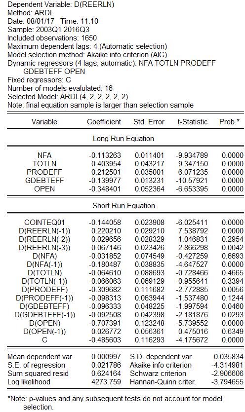

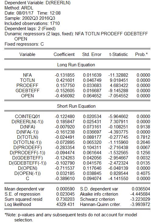

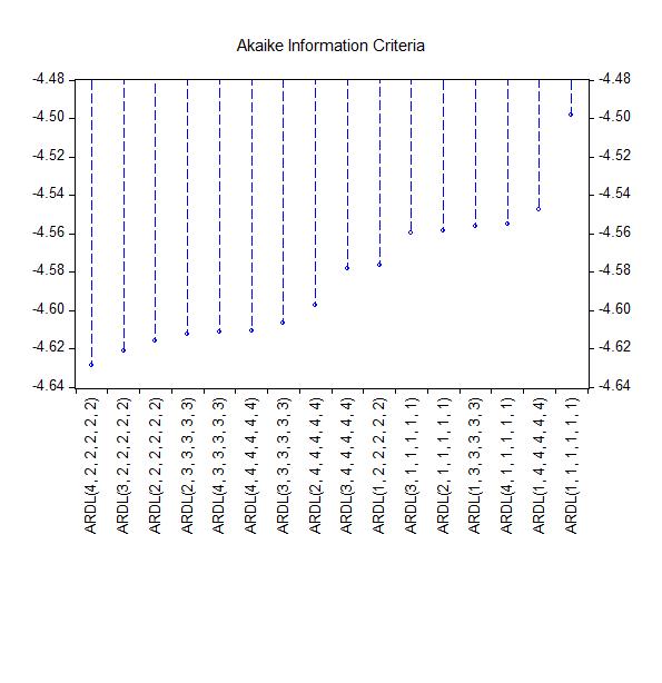

I run the following code to retrieve the lags selected by AIC, using ARDL/PMG panel estimator.
The code searches for the minimum AIC.
I noticed the following:
- The code above selected (2,2) as the best lag with an AIC = -4.446
- EViews selected a lag length of (4,2) with an AIC of -4.315.
- However, the "model selection summary" (see graph), gives an AIC of -4.629 for the (4,2) lag lenth and -4.616 for my selected lag length of (2,2)
Why is the AIC changing from the ones presented in the estimation results to the ones in the "model selection summary"?
Is that because the model is being selected prior to the ECM re-parametration?
Thanks for your attention.
'run ARDL/PMG estimation
!maxlagcrit=4
!mininfocrit=10
for !lagdep=1 to !maxlagcrit
for !lagexp=1 to !maxlagcrit
equation _eqardl_aic.ardl(fixed,deplags=!lagdep,reglags=!lagexp) G
if _eqardl_aic.@aic<!mininfocrit then
!bestlagdep=!lagdep
!bestlagexp=!lagexp
!mininfocrit=_eqardl_aic.@aic
endif
next
next
equation _eqardl_aic.ardl(fixed,deplags=!bestlagdep,reglags=!bestlagexp) G

Re: retrieving lags selected by AIC/BIC
It is probably due to dropping of lags.
When performing model selection up to, say, 4 lags, each of the 4 models (1,2,3,4) have to be tested on the same sample - so you have to drop four observations at the start for each estimation.
Then if you selected 2 as the the best model you re-estimate a 2 lag model this time only dropping two observations. That means that the information criteria from the final estimation is (slightly, hopefully) different from that used during model selection.
