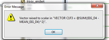

I thought the EViews syntax would be simple and I've been trying this:
vector C1F3 = @sum((eig_d4 - mean_eig_d4)^2)
But, I'm getting an error message that states "Vector raised to scalar." Which is odd. The result should indeed be a scalar, but I don't understand the problem here.

The ^ operator doesn't perform element by element exponentiation, but the @epow function does.
scalar C1F3 = @sum(@epow(eig_d4 - mean_eig_d4, 2))
