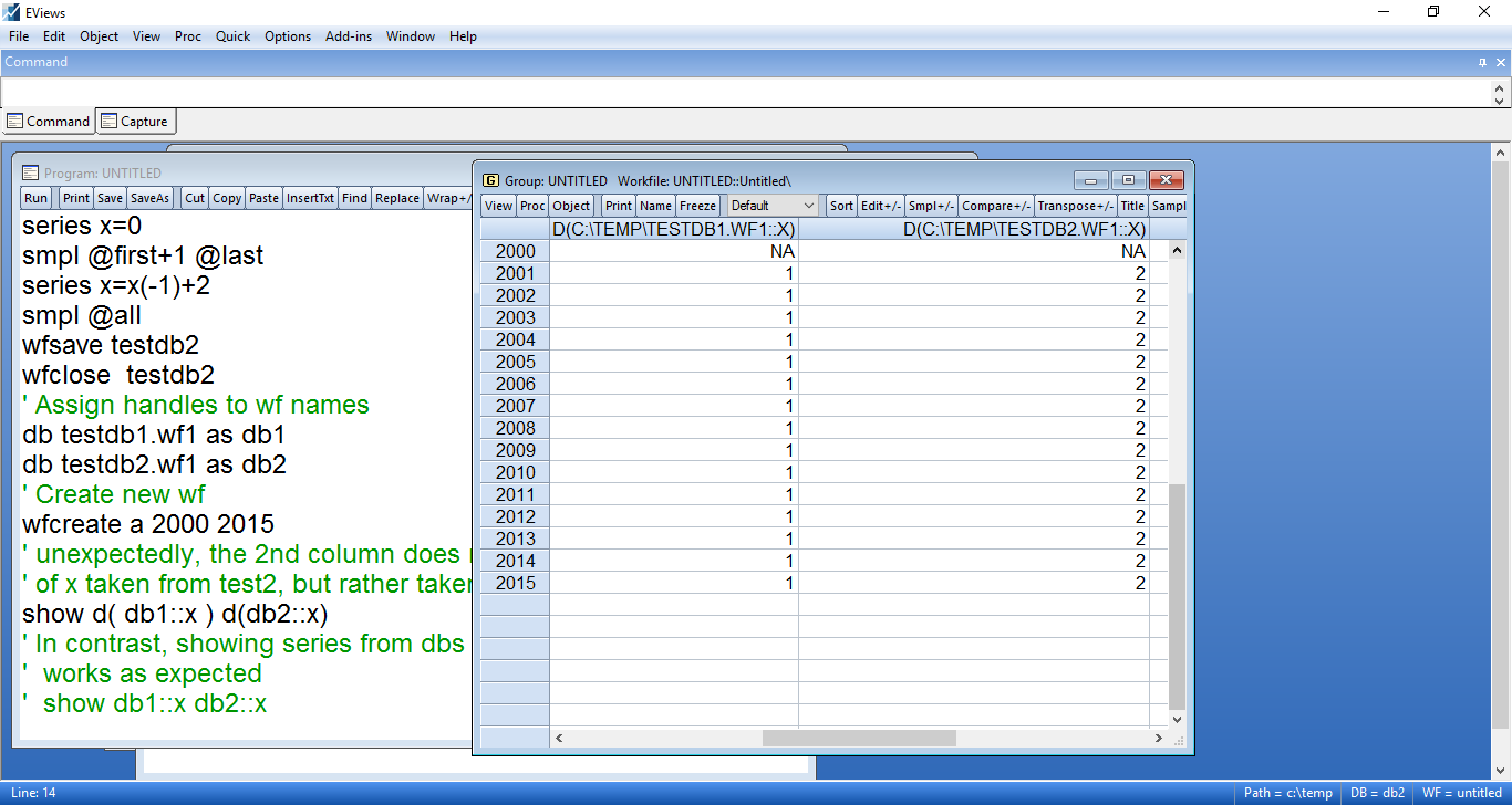

It is supposed to work, and does, I think. When I ran your code, I received the expected result.

Postby EViews Gareth » Fri Feb 17, 2017 5:26 am
i.e.

indeed, it works as intended if the name of the working directory does not contain spaces (like "c:\temp" as in your example).
Otherwise, the result I have reported can be replicated.
The code below is the same as before, except the 2nd line which changes to a working directory with a "spacy" name.
Best,
mamo
' Change to a directory with spaces in the name cd "C:\temp\This is a test dir" ' Create two wfs, testdb1 and testdb2, to be used as dbs later on wfcreate(wf=testdb1) a 2000 2015 series x=0 smpl @first+1 @last series x=x(-1)+1 smpl @all wfsave testdb1 wfclose testdb1 wfcreate(wf=testdb2) a 2000 2015 series x=0 smpl @first+1 @last series x=x(-1)+2 smpl @all wfsave testdb2 wfclose testdb2 ' Assign handles to wf names db testdb1.wf1 as db1 db testdb2.wf1 as db2 ' Create new wf wfcreate a 2000 2015 ' unexpectedly, the 2nd column does not show 1st differences ' of x taken from test2, but rather taken from test1 show d( db1::x ) d(db2::x) ' In contrast, showing series from dbs without transformation ' works as expected ' show db1::x db2::x
