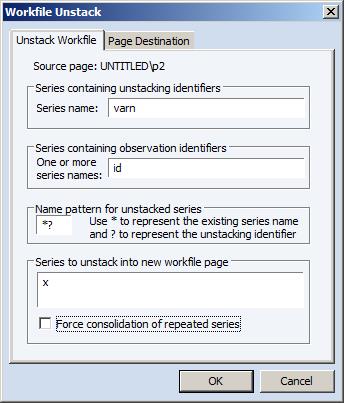

I find that unstacking using the menu as compared to using the pageunstack command seems to make difference if the series containing the unstacking identifier has only one (repeated) value (see example in the code below). Particularly, it seems that in this case the option "Force consolidation of repeated series" should be unchecked in the menu.
I am wondering what the equivalent option in the command "pageunstack" is?

mamo
Posts: 209
Re: pageunstack
Postby mamo » Fri Feb 10, 2017 2:42 am
Missing picture now here in the attachment
Best, mamo
Re: pageunstack
Postby EViews Jason » Fri Feb 10, 2017 10:04 am
To match the dialog, use the 'noconsolidate' option.
pageunstack(namepat=*?, noconsolidate) varn id @ *
We must have missed it when we wrote the documentation. I'll make sure we add it.
FWIW, I found the undocumented option via the generated command capture.
