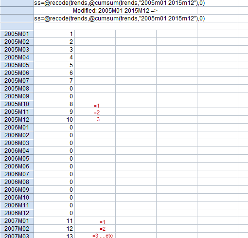

the fisrt code it generate dummy for each date, when i use in the second code @cumsum(1) it generate continuous trend.
from 2005m01 2005m07 the trend start by 1 to 7
from 2005m10 2005m12 it start by 10 to 12 (should start by 1 to 3)
........etc.
is there an easy way to do all this by simple code.

generate trend from 2005m01 2005m07 start by 1 and finish by 7. (7 obs)
generate trend from 2005m10 2005m12 srat by 1 2 3. (3 obs)
generate trend from 2007m01 2007m04 start by 1 2 3 4 . (4 obs)
generate trend from2008m01 2009m02 start by 1 2 3 4 5...14 (14 obs)
for example if i use this code
series trends=@recode(@during("2005m01 2005m07") or @during("2005m10 2005m12") or @during("2007m01 2007m04") or @during("2008m01 2009m02"),1,0)
series ss=@recode(trends,@cumsum(trends),0)
how can transforme the value 1 in trend (broken trend)

i get the same result when i write this code Mr Gareth, and it take long time to use smpl each time
smpl @all series ss=0 smpl 2005m01 2005m07 series ss=@recode(trends,@cumsum(trends),0) smpl 2005m10 2005m12 series ss=@recode(trends,@cumsum(trends),0) smpl 2005m10 2005m12 series ss=@recode(trends,@cumsum(trends),0) smpl 2007m01 2007m04 series ss=@recode(trends,@cumsum(trends),0) smpl 2008m01 2009m02 series ss=@recode(trends,@cumsum(trends),0) smpl @all
