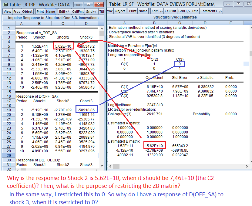

I made two SVAR with the two types of restrictions; you will find the both SVAR enclosed; SVAR_SR restricted by the matrix ZA and ZB and SVAR_LR restricted by ZB only.
For the SVAR_SR, I find the estimated values of the restriction matrixes in the IRF, as expected. Indeed, you will see that the the Response of A_TOT_SA for Shock 2 in the SR_IRF table and the C(3) coefficient SR_SF table are the same; 51294.
This is not the case, for the SVAR_LR. For the same response to the same shock (A_TOT_SA for Shock 2), I see a 5.62E+10 reponse in LR_IRF table. This is the value of matrix B, first row second column (see LR_SF table), but not C(2).
So, what is the use or the purpose of the C(1), C(2) and C(3) coefficients of the restriction matrix ?
And in the LR restriction matrix (matrix ZB), the variables I had restricted to 0 do not "get" a 0 response from the shocked variable. I really do not understand the purpose of the ZB matrix and the C(1 to 3) coefficients then.
Could you please help me, I am really stuck.
Thank you very much in advance!
data eviews forum.wf1
(58.48 KiB) Downloaded 541 times
