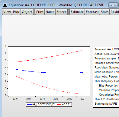

Hi - I am looking for the data behind the red lines (2 S.E.) in attached chart which is automatically created when a forecast is run. Please could you point me in the right direction?
Forecast output chart.PNG (16.88 KiB) Viewed 2394 times

When you do the forecast, there is the option to save the standard errors. You can calculate the red lines from that.
