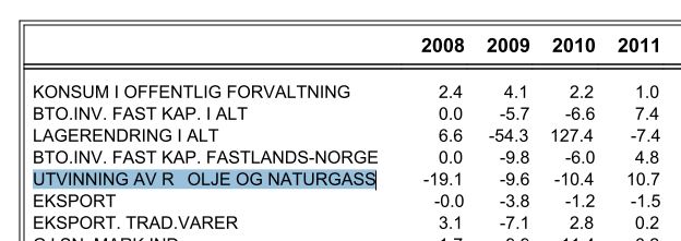

Postby tvonbrasch » Fri Sep 16, 2016 12:42 am
When I save a table to pdf i get a border around the whole table
Norwegian vowels2.JPG (37.95 KiB) Viewed 2809 times
What command can I use to remove this border?
Re: Border around table
Postby EViews Jason » Fri Sep 16, 2016 8:33 am
Unfortunately there isn't a command. We should arguably add one but for the time being, you will have to turn it off globally by selecting File->Print Setup and then unchecking the 'box around tables' box
