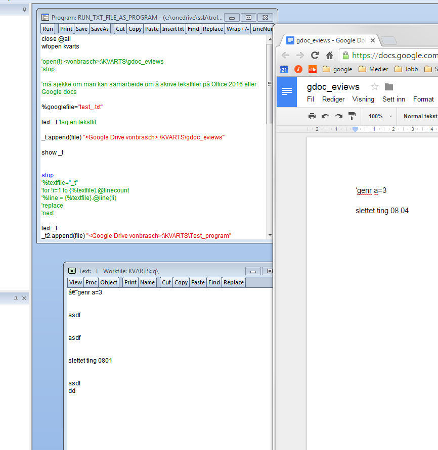

I still experience some problems when downloading text files from Google Drive.
1) a textfile in Google Drive
‘genr a=3
is read by Eviews as
‘genr a=3
. This is much better than what it was. Now I can just replace
with the apostrophe
. But it would be great if you could fix this also. The apostrophe
is often used in Eviews programs to comment out stuff.
2) For some reason, when I make changes to a Google Drive document, it still can take some time before the updated version is downloaded into Eviews correctly. I ran a program 08:06, but changes I had made to the text file 2 minutes earlier (08.04) was not updated when downloading into Eviews, see picture:
Eviews does not update.PNG (68.27 KiB) Viewed 20660 times
. I am not sure what is causing this. Manually downloading the file from within Eviews yields the same text file as when downloading it within a program.

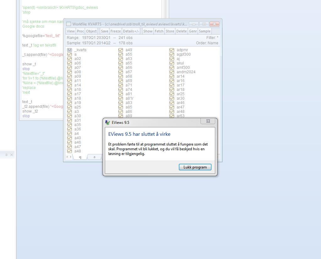

3) Eviews stops working: When trying out downloading text files from Google Drice to Eviews, Eviews has stopped working five times during a period of about 20 minutes, see picture:
Eviews stop working when downloading file from Google Drive.PNG (53.23 KiB) Viewed 20660 times
I hope this is also something you can fix. We are now so close to being able to use Google docs as a platform for running Eviews programs.
Re: simultaneous editing of program files
Posted: Fri Aug 12, 2016 8:10 am
by EViews Jason
1)The main problem is google docs supports unicode and EViews does not. EViews assumes text files and programs are in ascii. You can fix this specific problem by selecting (in google docs) tools->preferences and then deselecting 'Use smart quotes'. To be more EViews/ASCII compliant, you should also deselect 'Automatic substitution'.
2) We are still working on this one.
3) We will get this fixed as well.
