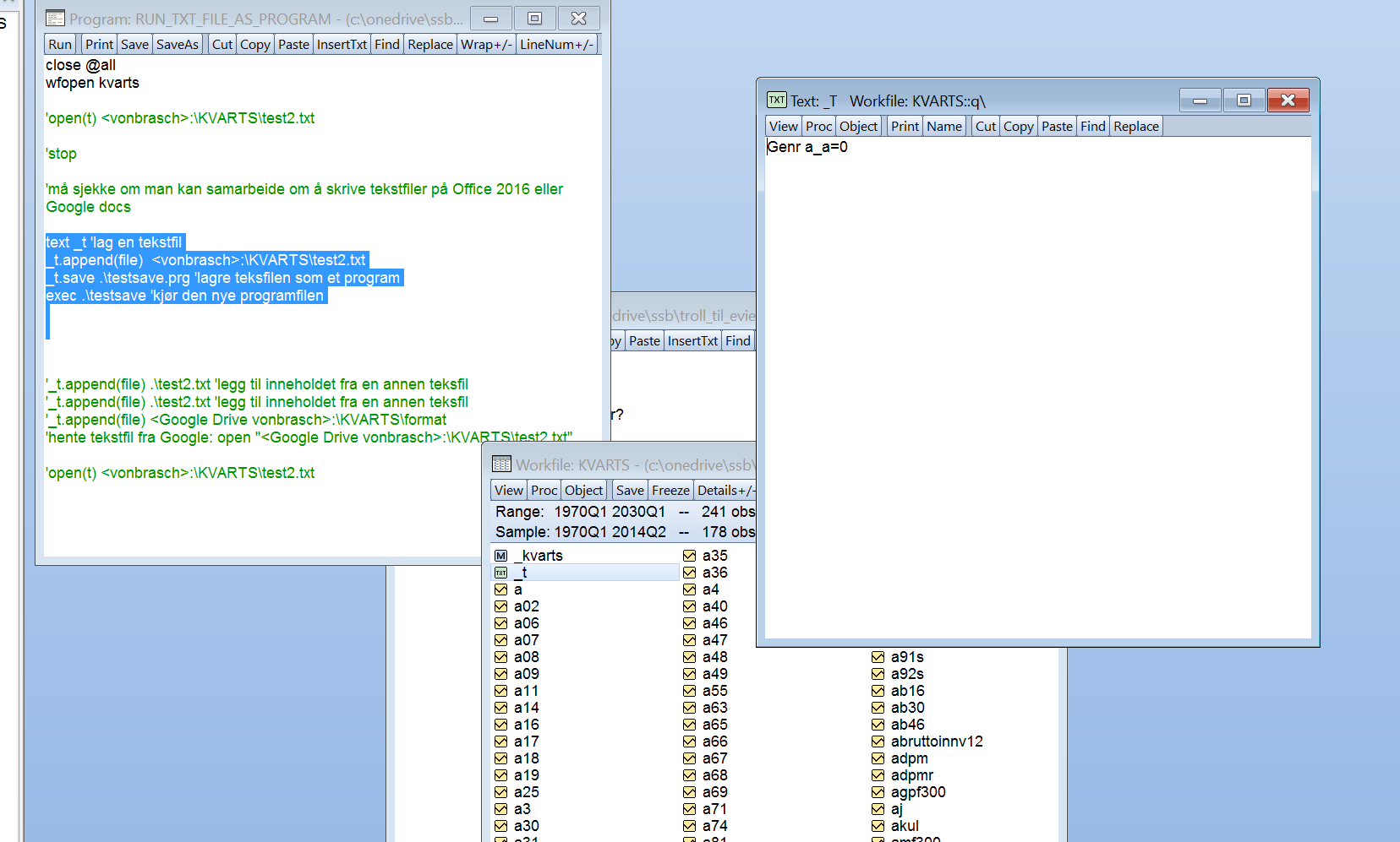

i get the error message:
"Ï»¿GENR is not defined or is an illegal command in "Ï»¿GENR
A_A=0" in TESTSAVE.PRG."
attached is a picture of the error message, a picture of the text file loaded in eviews, and the text file downloaded from google docs.
Do you understand what is causing this error?

- Posts: 870
Re: simultaneous editing of program files
The test2.txt file appears to contain some unicode characters that does not appear in notepad or after it has been read in by EViews. This explains the strange start of the error message "Ï»¿GENR ..."
You will have to remove these characters from the text file that you normally use.
The attached file does not have the extraneous characters.

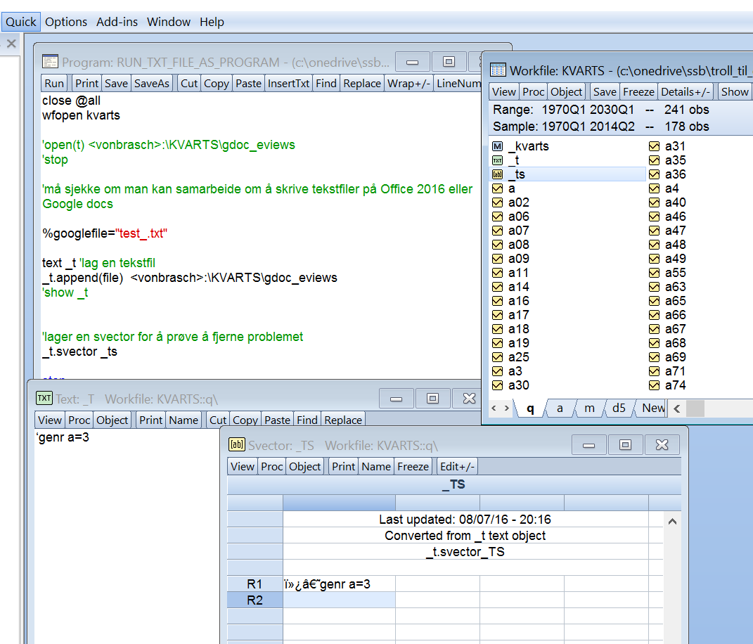

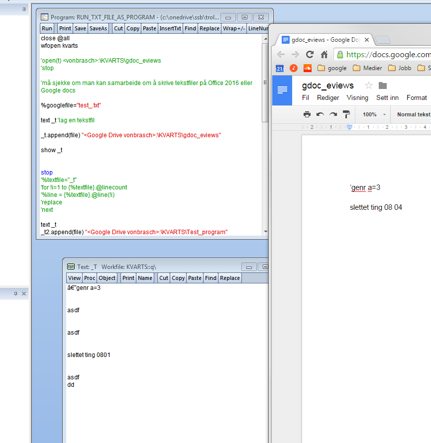

But, as I notet in my previous post, when loading the text file as a program file it reads the characters:
See attached photo. You say that this means there are some Unicode characters that Eviews do not read. But if Eviews cannot read simple google doc text files, there is not much point in being able to access google docs….? Can you please fix it so that eviews understands the text:‘genr a=3
? Since Eviews displays the google doc correctly in Eviews as a text object, it must “understand” the Unicode characters, and hopefully it should be easy for you guys to fix this.‘genr a=3

When saving text files on Google drive, apparently Google adds 'byte order marking' to the beginning of every text file. This tells the reading application the file encoding. We will get this fixed.

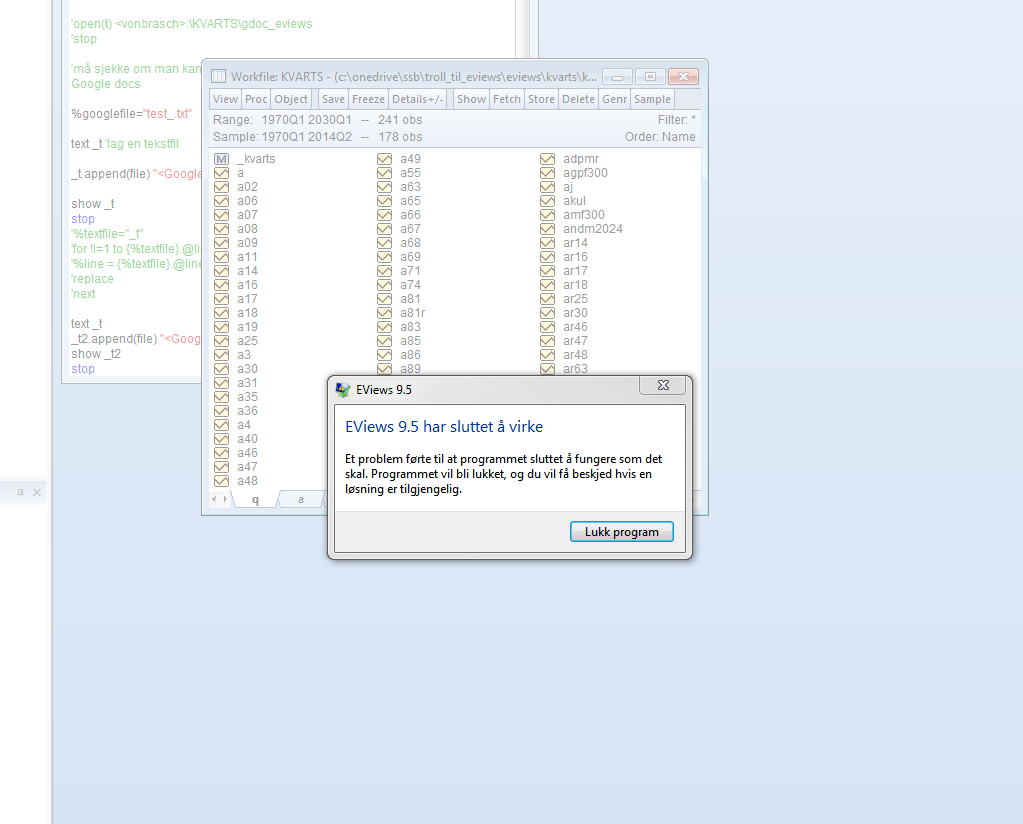

2) For some reason, when I make changes to a Google Drive document, it still can take some time before the updated version is downloaded into Eviews correctly. I ran a program 08:06, but changes I had made to the text file 2 minutes earlier (08.04) was not updated when downloading into Eviews, see picture: . I am not sure what is causing this. Manually downloading the file from within Eviews yields the same text file as when downloading it within a program.
3) Eviews stops working: When trying out downloading text files from Google Drice to Eviews, Eviews has stopped working five times during a period of about 20 minutes, see picture: I hope this is also something you can fix. We are now so close to being able to use Google docs as a platform for running Eviews programs.

is read by Eviews as‘genr a=3
. This is much better than what it was. Now I can just replace‘genr a=3
with the apostrophe‘
. But it would be great if you could fix this also. The apostrophe'
is often used in Eviews programs to comment out stuff.'

1)The main problem is google docs supports unicode and EViews does not. EViews assumes text files and programs are in ascii. You can fix this specific problem by selecting (in google docs) tools->preferences and then deselecting 'Use smart quotes'. To be more EViews/ASCII compliant, you should also deselect 'Automatic substitution'.
