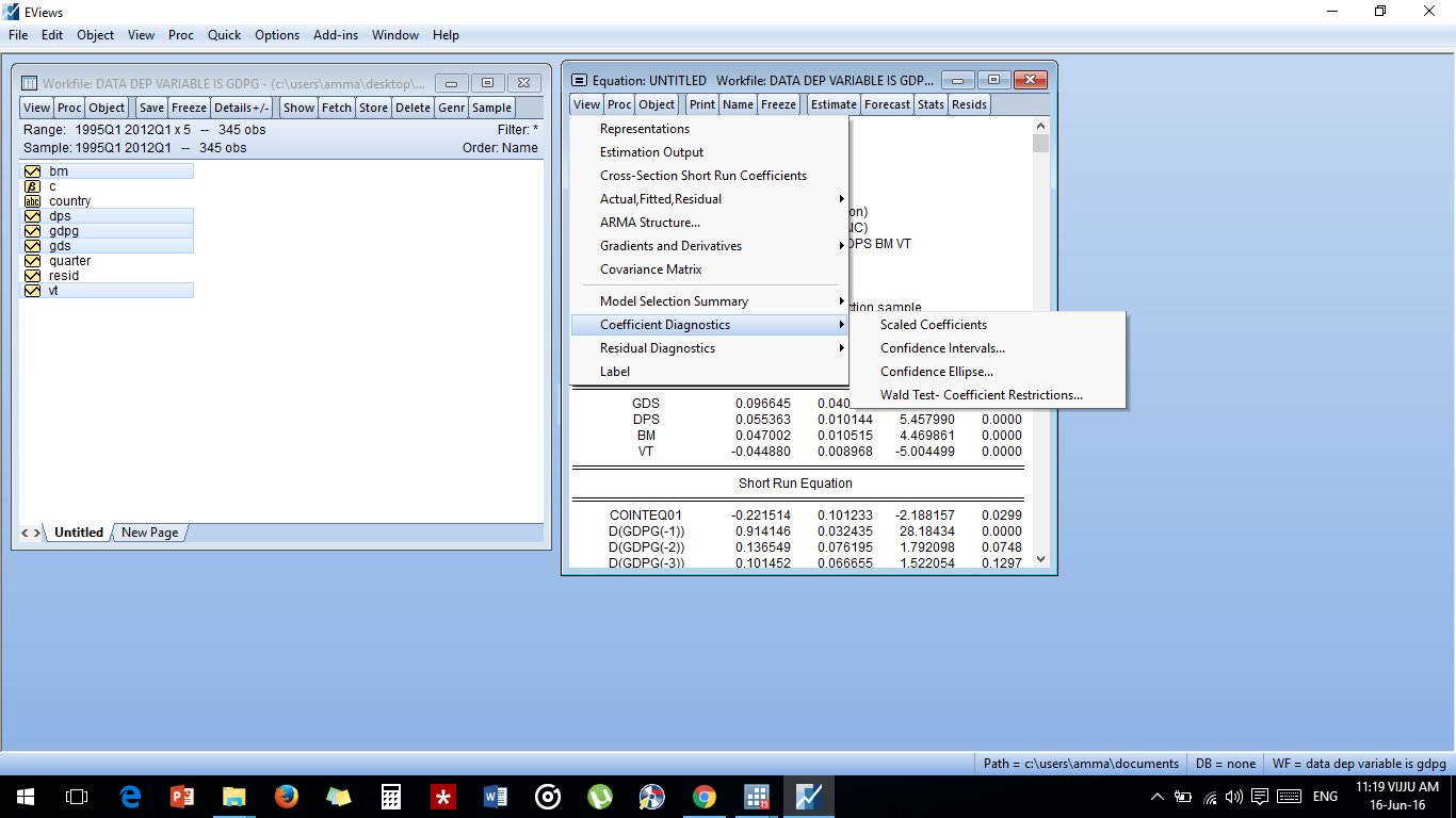

hai could you please help me in this the problem is in estimating the ardl approach in eviews 9.5 after estimating the equation i am unable to find the bound test and cointegration and long rum form in the coefficient diagnostics kindly please help in this the others are also missing in the coefficient diagnostics

Re: missing ardl bound test option in coefficient diagnostic
Postby vijjumodi » Wed Jun 15, 2016 10:55 pm
thank you mam, for your reply here u can find my attached files i was asking about the bound tests and which are missing in the coefficient diagnostics which is visible in the screenshot attached and also even though i do have an addon of ardl bound test i jus tneed it in the coefficent diagnostics and also the other things are missing there pls help.
the dependent variable in the data file is gdpg
Screenshot (238).png (93.79 KiB) Viewed 5138 times

Posts: 13608
Postby EViews Gareth » Wed Jun 15, 2016 11:21 pm
They are not available for panel workfiles

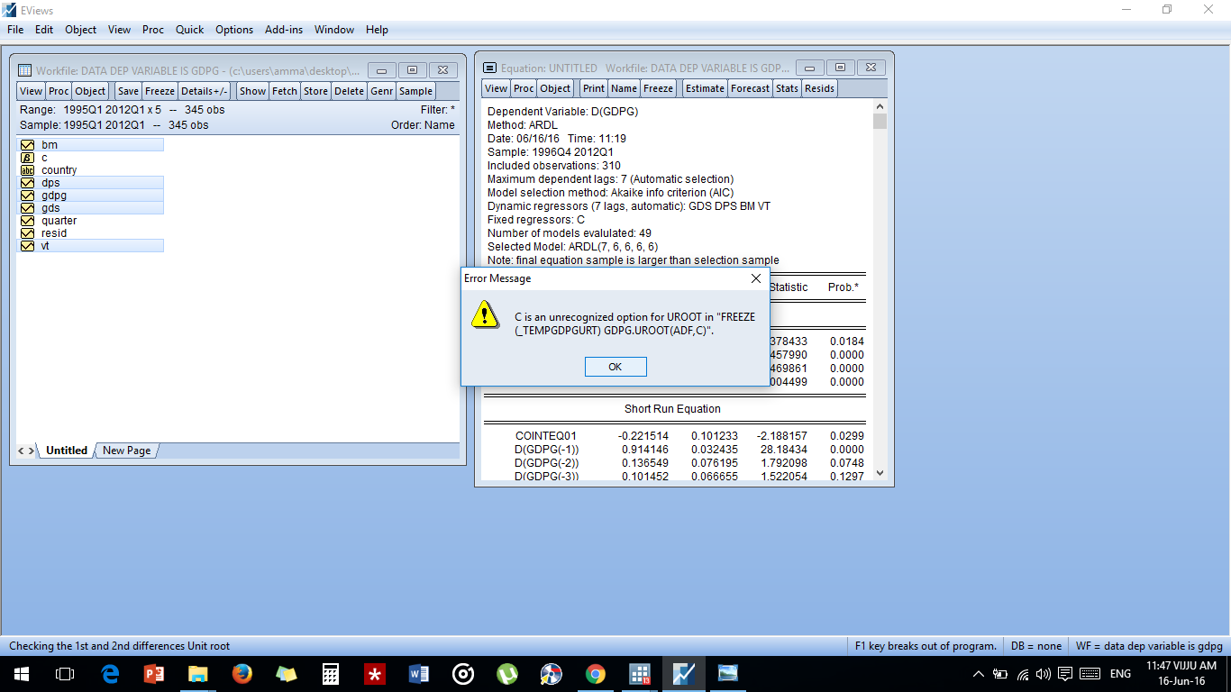

Postby vijjumodi » Wed Jun 15, 2016 11:33 pm
please help me in testing the bound test for the panel workfile and while using the add-on for ardl bound test after entering the variables i have got the error message which i have attached the screenshot and also pls confirm me whether that the addon is for panel workfile or not.
Screenshot (239).png (100.7 KiB) Viewed 5128 times
