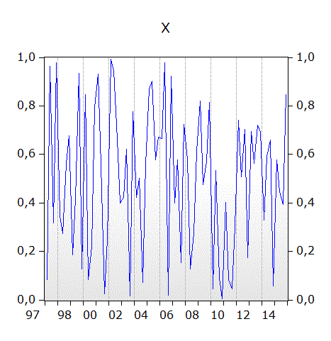

When doing some settings in a graph there is a problem with the bottom date/time axis. For example, the code below create a graph with an x-axel that shown every other year, starting 98. So far so good, byt the year 97 is also visibly and is positioned too far to the left. It shouldn't be there all (I think)
Regards Johan
wfcreate q 1997 2015 series x=rnd graph gr.line x gr.options size(3,3) gr.datelabel format(yy) gr.datelabel interval(y, 2) gr.axis(b) angle(0) show gr

We are looking into the issue and will report back when it is fixed

The next patch will have it fixed
