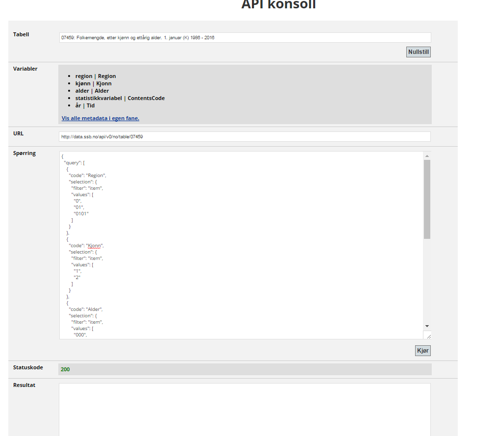

To me it looks like that Eviews then imports the query infomration (see attached picture).
If you go into the API console http://data.ssb.no/api/v0/no/console and start to enter "07459:" you can choose "07459: Folkemengde, etter kjønn og ettårig alder. 1. januar (K) 1986 - 2016". If you then press "Kjør" (Run) you get the values of the different statistics in the json-stat format. this can also be saved in an Excel file. what I was hoping is that these data can be directly imported into Eviews, so that Eviews first queries the SSB database and then import these data into Eviews.
Is this possible?
Is this possible?

The command wfopen(t=text) http://data.ssb.no/api/v0/dataset/85430.csv?lang=en works fine.
However, the reason that it works is because SSB published only a limited set of variables on the cite http://data.ssb.no/api/ that could be directly downloaded as .csv files. (the table 85430 is one of them)
The full databank must be accessed through an API console: http://data.ssb.no/api/v0/no/console
and then query the data. In the console the data is then retrieved and can be stored as a CSV file or in JSON format (im not sure what that is).
I noticed that other software could query and download data directly into the program, which would be extremely convenient. And I was told that many providers of statistics are using the same type of api/json for computers to access data directly. would this be possible in Eviews? If not, this is also on my wishlist for Eviews 10.
