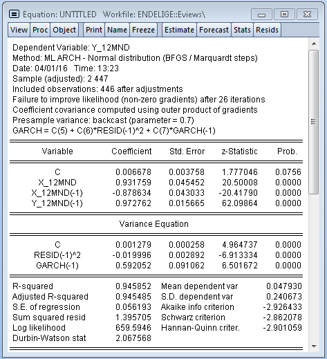

We are wondering why we get a negative resid(-1)^2 coefficient in Garch variance equation. If anyone could shed some light on this, we would be most thankful. Please see the attachment.

Your output reads: "Failure to improve likelihood (non-zero gradients) after 26 iterations". In other words, you are experiencing a convergence problem. It also seems you have a very weak GARCH effect in the residuals. Either there is really no significant GARCH effect, or the mean equation is not stationary.

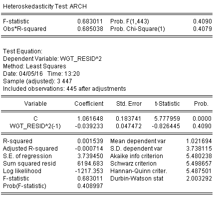

We have done unit root tests of data series, as well as ADF and KPSS test. The result from ADF showed that data series was stationary, while KPSS test showed that it was not stationary. We also found that it was no ARCH effect in the model. See picture. We are also wondering how we find out if the GARCH effect is significant?
Kind regards
Eager Norwegian students

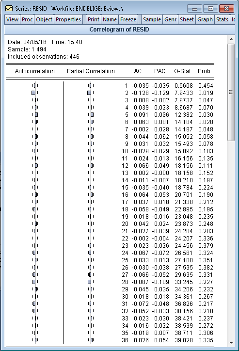

Our variables are in first differences. Our depended variable is (Spot [t+1]-Spot[t])/Spot[t], and our independent variable is (F[t]- Spot[t])/Spot[t]. We have checked the correlogram of the residuals and there is no serial correlation, see the attachment. So that means there is no significant GARCH effect?
Kind regards
- Correlogram.PNG (32.19 KiB) Viewed 16968 times
Re: Negative resid(-1)^2 coefficient in Garch variance equat
Q-stats (and the related p-values) disagree with you. There are some significant lags indicating a possible serial correlation. As for the GARCH effect, you should look at the correlogram of squared residuals and then formally test for heteroscedasticity. It is hard to detect the source of the problem (if any) without seeing the actual data.
