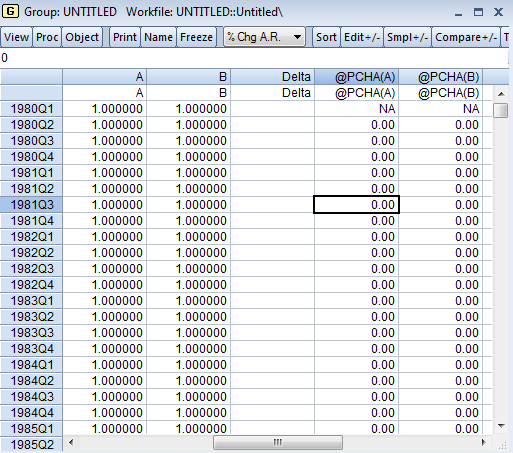

I am starting with series A and B both = 1.
Starting point

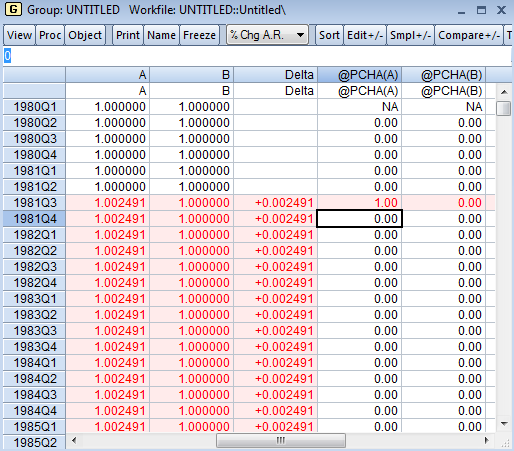

If I make changes to @PCHA(A), the series A level increases in that period and continues at that level going forward.
@PCHA change

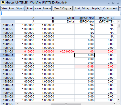

If I revert the change, switch to making changes to @PCHY(A), and make a change, the series A level only increases in that specific period.
@PCHY change
It seems that for @PCHA(A), EViews keeps the change to the level applied through the rest of time, whereas changing @PCHY(A) only alters one time period's level.
Can you please explain why the changes seem to have different impacts? Is there a way to choose the impact? For instance, if I want to change the @PCHY(A) to 1%, but keep the adjusted level of A for the rest of time.
