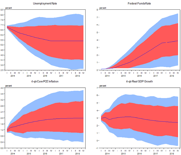

Hi everybody,
how can make shaded graph for forecasting like this picture.
- laubach_fig2_20140403.jpg (192.51 KiB) Viewed 15094 times
Re: make shaded graph for forecasting
This is a fan chart.
The EViews blog will have a post on creating fan charts soon!
