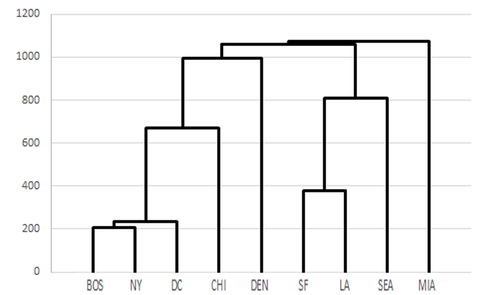

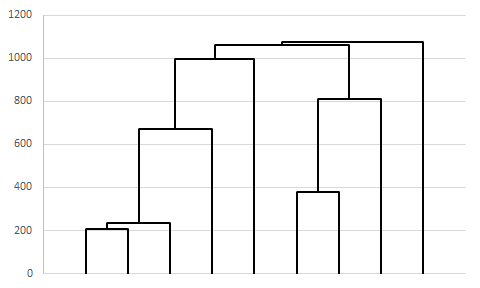

After you click run, you have all the things you need to map out the hierarchical clustering of any data set. If you wanna go overboard (like me) you can use the values in final_output to create a dendrogram like this:
* I haven't found a way to create an output for the construction of a dendrogram like this. The attached dendrogram here is one that I painstakingly made using an X Y scatter in excel. If someone can code a solution for the construction of one within Eviews, please share.

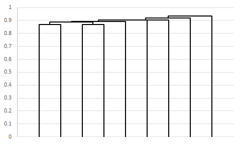

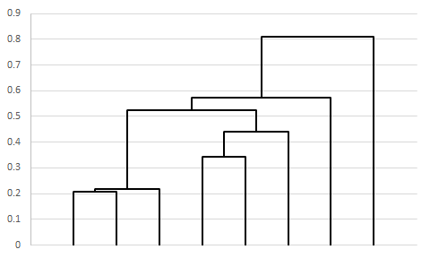

With this you can create any number of dendrograms. To demostrate:
Even highly random data,
