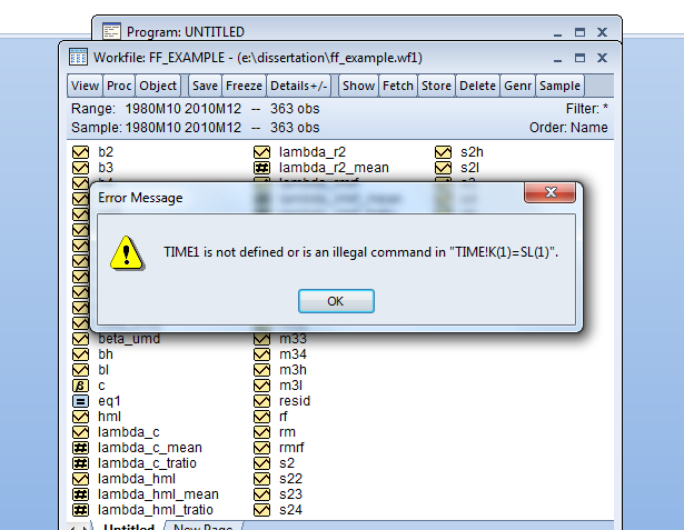

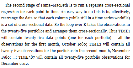

The purpose of the part of code contains error is attached as a picture. The error is attached as a picture. Could anyone help me to fix this problem?

Problem Sovled
The code define SERIES TIME is wrong.
It should be SERIES TIME{!M} instead of SERIES TIME{%M}
