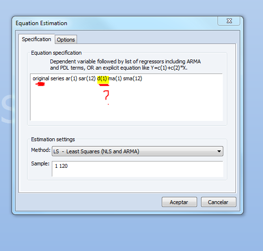

So, in this case, we can write the first difference in the estimate equation as d(1) or not?? in order to work directly with the original series.
What is your opinion??
For example:
Thanks for your help.

Postby EViews Gareth » Tue Feb 09, 2016 9:42 am
I don't understand your question. Just write the dependent variable as d(myseries). You can include lags as independent regressors if you want - it doesn't change anything.
