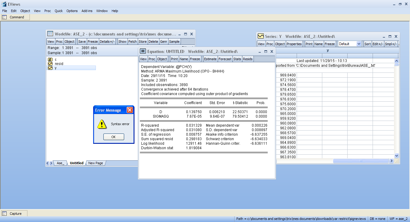

hi,
when i estimate the ARFIMA model i use @pch(y) c d, after i use forecast; the message appear ''syntax error !",( same problem when i use dlog(y) c d ) i have the last update.
can you help me.

Postby EViews Gareth » Wed Nov 04, 2015 12:00 pm
We cannot replicate this. Could you provide your workfile?

Postby EViews Gareth » Sun Nov 29, 2015 8:02 am
What's the build date of your copy of EViews (Help->About EViews)

Postby clubmed » Wed Dec 02, 2015 12:27 pm
it work fine now with the update :D , thanks Mr Gareth.
