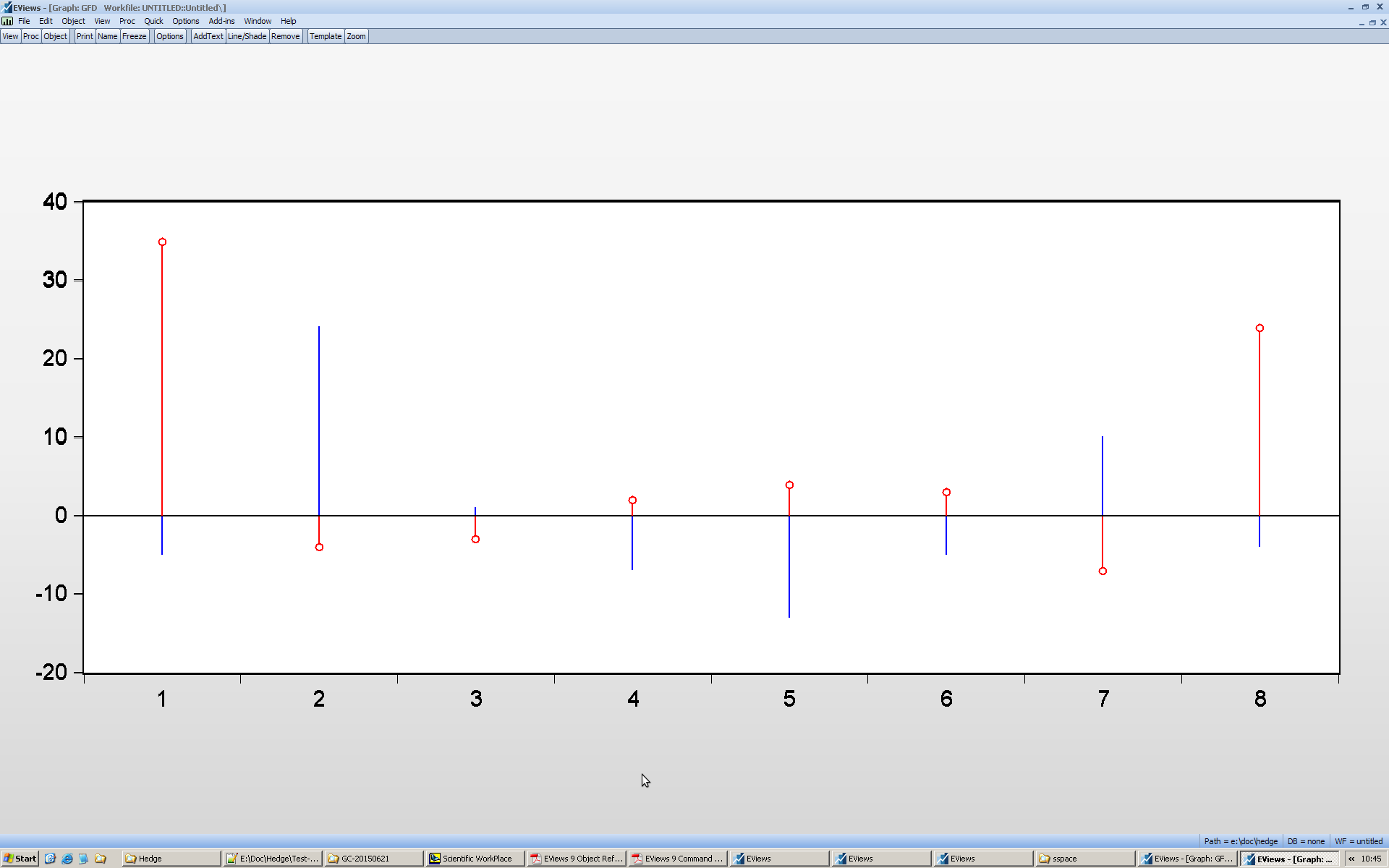

I am using spike to depict the opposite direction in movement of two price (where x*y<0)
However, spike does not provide an option to align the two series. Thus, I produce 2 graphs, and overlay them
'2015-08-17 10:20 EV9.20150728 'overlay two graph wfcreate u 8 series x series y x.fill -5, 24, 1, -7, -13, -5, 10, -4 y.fill 35, -4, -3, 2, 4, 3, -7, 24 graph gfx.spike x gfx.addtext(t) "" graph gfy.spike y gfy.addtext(t) "" gfy.setelem(1) lcolor(red) symbol(circle) graph gfd.merge gfx gfy gfd.options size(8,3) gfd.axis range(-20,40) gfd.align(1,0,-3.01) ' gfd.align(1,0,-3.02) ' gfd.align(1,0,-3.015)
the problem is that I can not achieve a perfect overlay. The best choice is align(1,0,-3.01), and it seems no different from align(1,0,-3.02) and align(1,0,-3.015).
Is it possible to find out an exact overlay?
