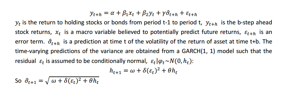

I am doing my dissertation and now I want to estimate a linear regression model include a GARCH term. The model and description has showed below:
I have 18 years stock return data, and some monthly macro variables data.
How can I estimate this equation in Eviews.
Thank you very much
Posts: 13608
Re: Estimate a linear regression model include a GARCH term
Postby EViews Gareth » Mon Jul 27, 2015 10:26 am
Create an equation object, set GARCH as the estimation method.
