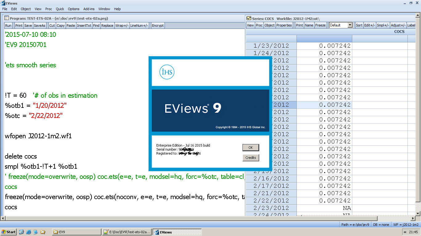

in my computer, the COCS are NOT a constant value of 0.008859
can not attach file larger than 2M, so the screen capture video, go see https://youtu.be/1lGNZ1u_C30
and the screenshot
screenshot
Screenshot from 2015-07-10 082924.png (66.36 KiB) Viewed 12516 times
Re: ETS, the smooth series
Postby EViews Gareth » Fri Jul 10, 2015 8:48 am

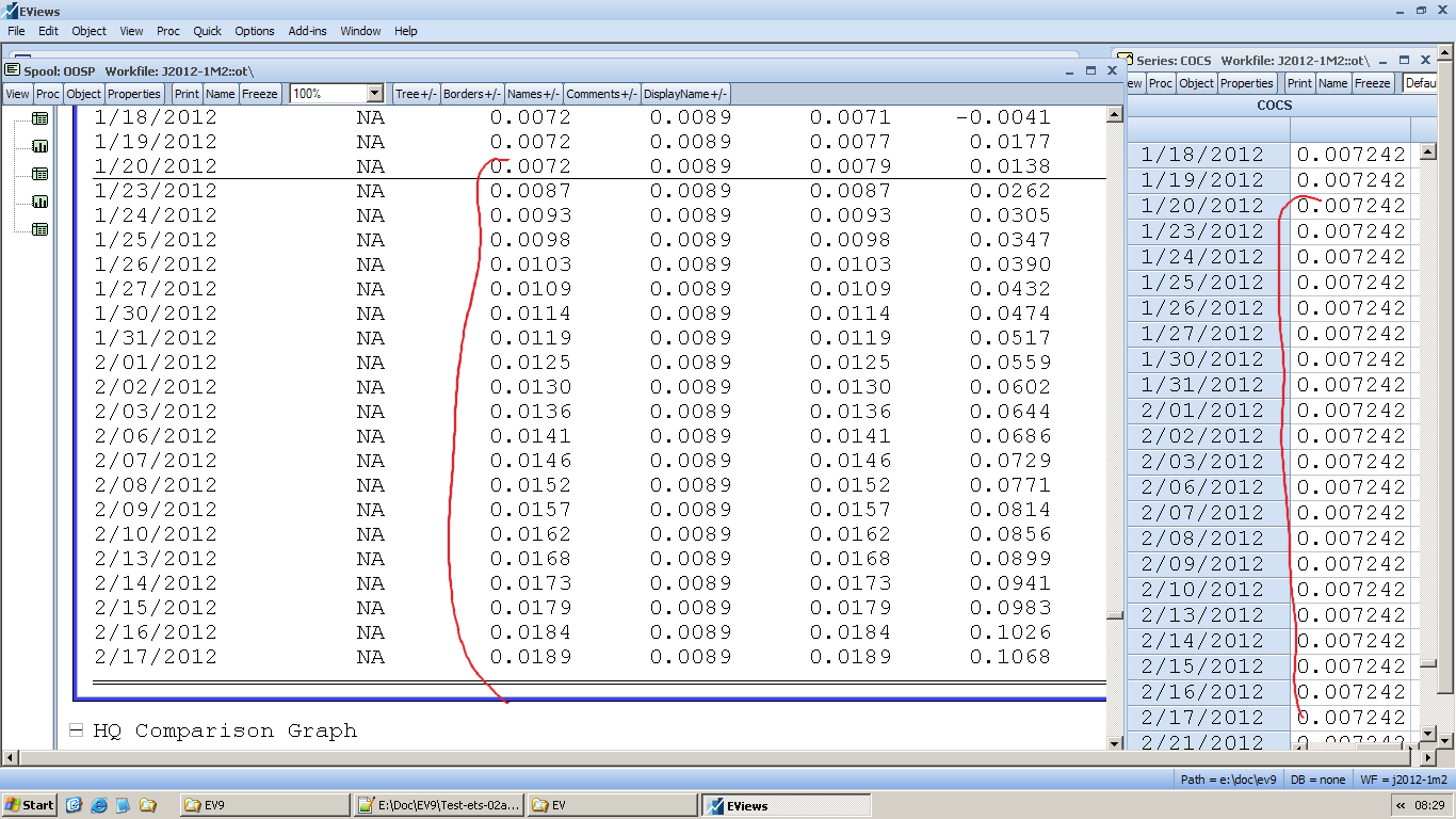

Postby maxchen » Sat Jul 18, 2015 7:00 am
unchanged, attached.
Screenshot from 2015-07-18 214525b.PNG (103.27 KiB) Viewed 12308 times

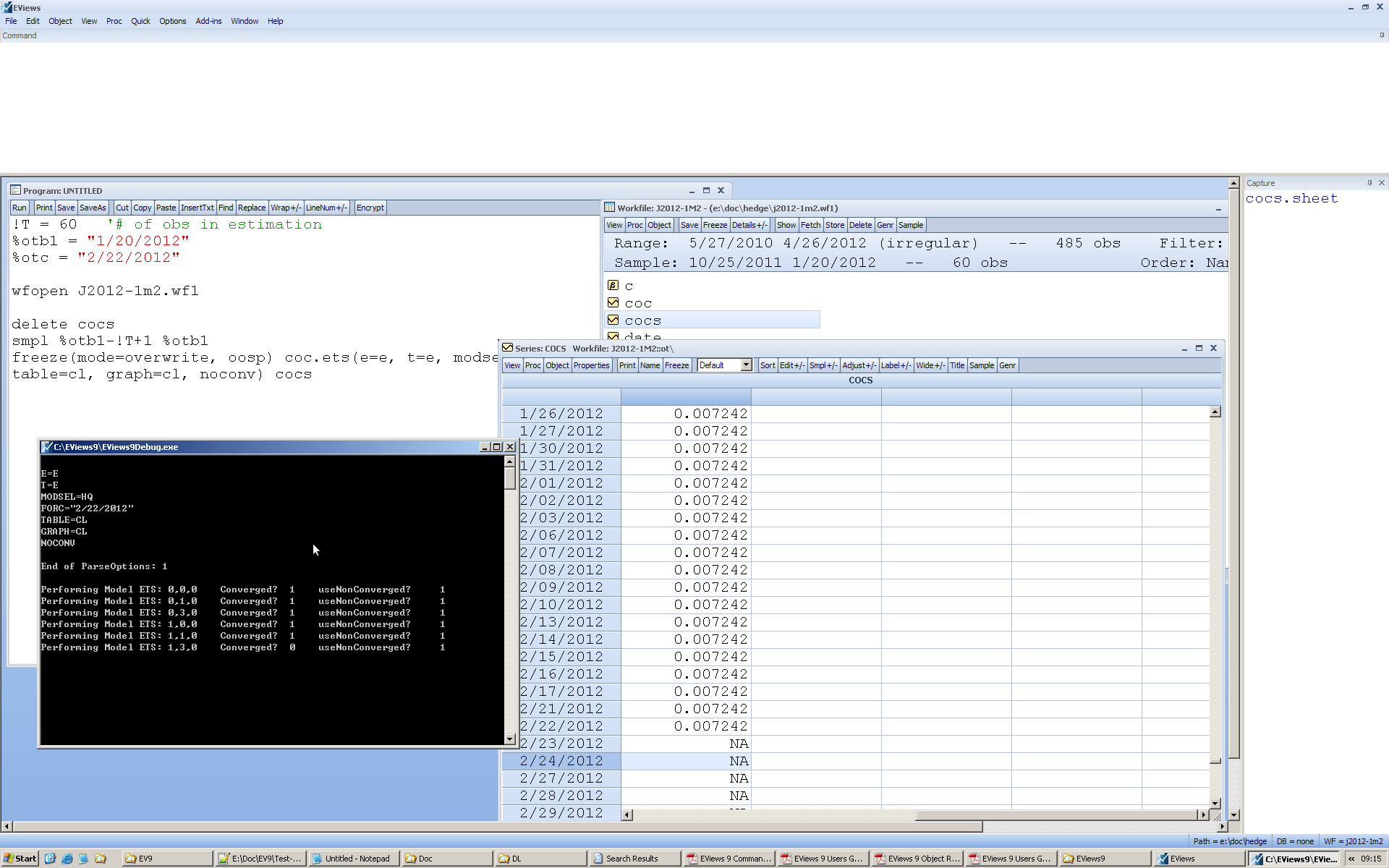

Postby maxchen » Mon Jul 20, 2015 6:39 am
I did those way every time.
I record just now: https://youtu.be/eNLSY1RUneU
first VM: win 7, brand new install, only EViews 9 (the notepad++ is green, copy into only, no need to setup)
the second VM: XP

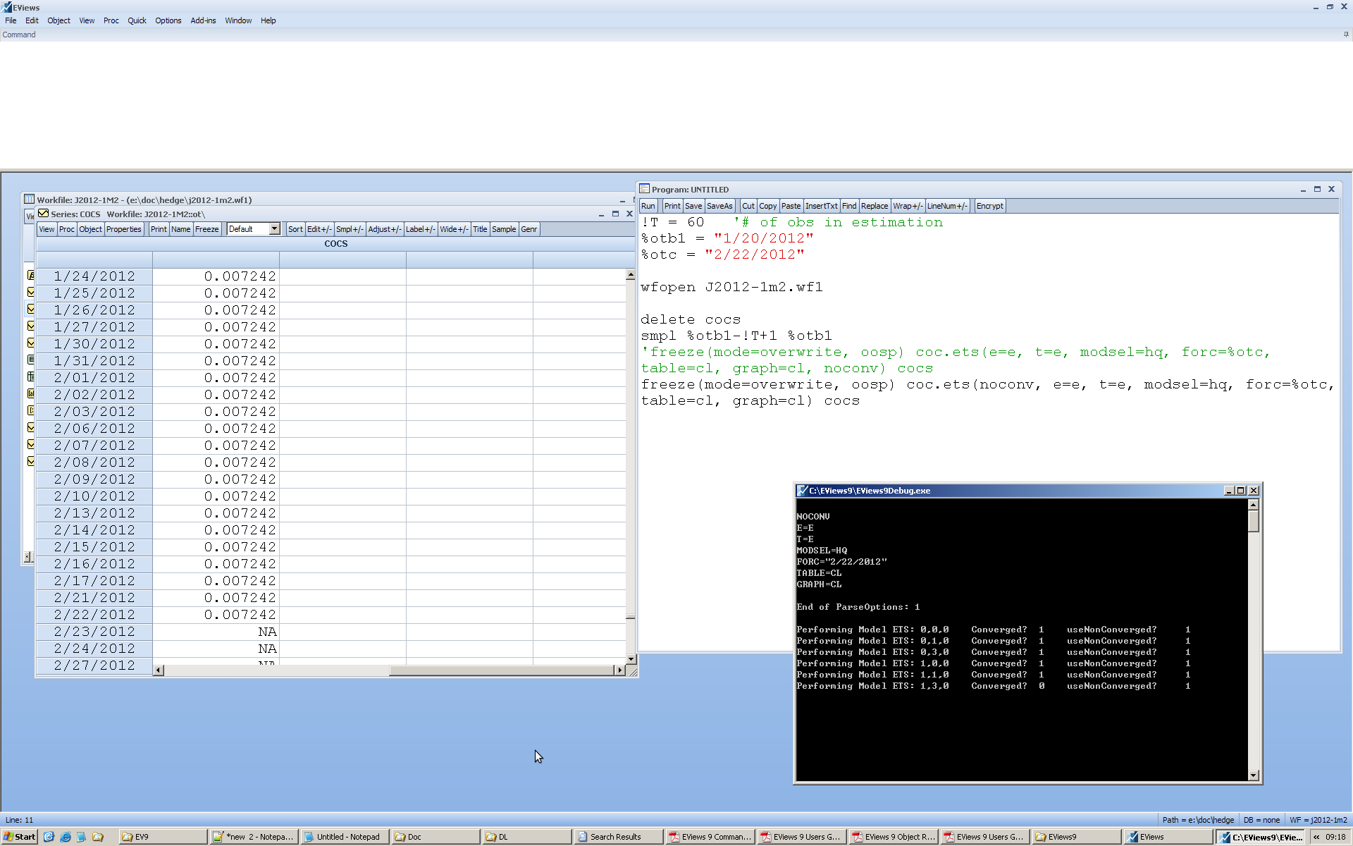

Postby maxchen » Mon Jul 20, 2015 6:21 pm
yeah, I do copy and paste from post 1.
noconv comes first
Screenshot from 2015-07-21 091846.png (75.08 KiB) Viewed 12207 times
noconv comes last
Screenshot from 2015-07-21 091521.png (81.41 KiB) Viewed 12207 times
