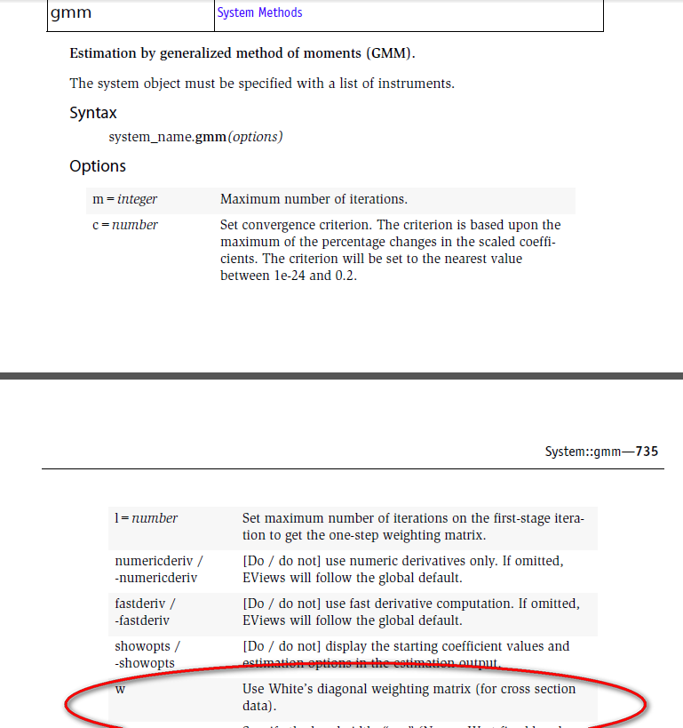

When you perform system estimation, one of the estimate commands is "GMM - Cross Section (White cov.)". However, when I try to program this using the "gmm" command, Eviews defaults to "GMM - Time Series (HAC)". How can I program using the cross sectional White covariance method? Note that Eviews says the estimation command is simply "gmm", but this is not correct, as it defaults to HAC.

Postby EViews Gareth » Tue Jun 30, 2015 8:51 am
From the EViews Object Reference:

Great, thank you. Note that I was looking in the command ref, and this option is not shown under GMM.
