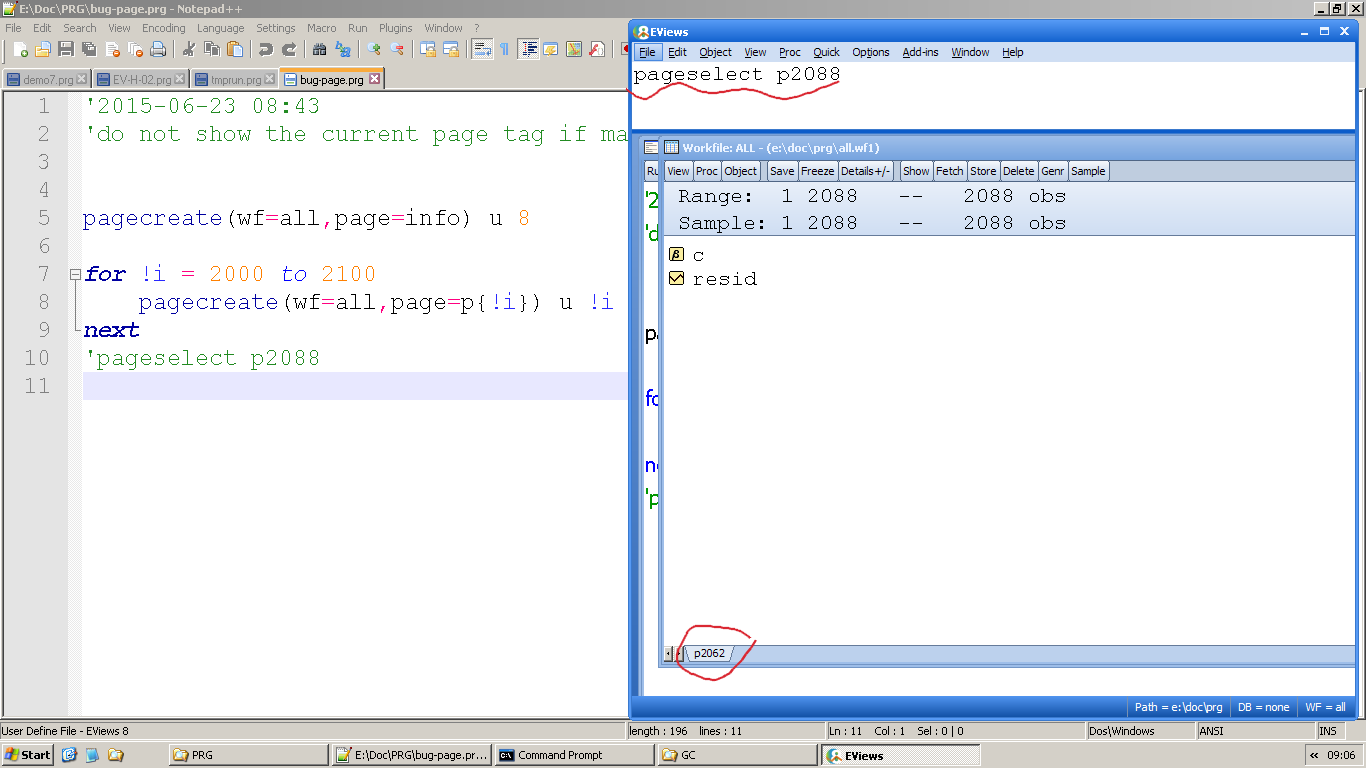

Postby maxchen » Mon Jun 22, 2015 6:16 pm
EViews8Patch_042715
pagecreate(wf=all,page=info) u 8 for !i = 2000 to 2100 pagecreate(wf=all,page=p{!i}) u !i next 'pageselect p2088
in cmd window, "pageselect p2088" the page content is correct, however, the page tag is p2062, not the p2088
screenshot
Screenshot from 2015-06-23 090613.png (49.98 KiB) Viewed 2900 times
Re: pageselect, page tag not the right one
Postby EViews Gareth » Wed Jun 24, 2015 8:14 am
Thanks, we'll fix in next EV9 patch.
