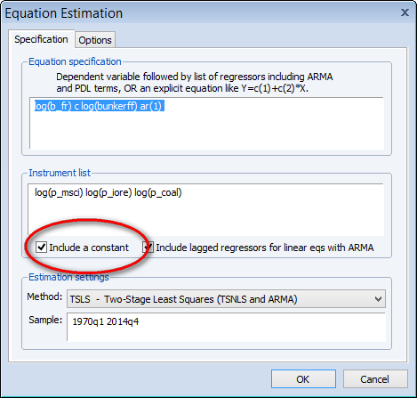

How can I remove the constant from the instrument list?

Uncheck the box that says "Include Constant".

I don't think I saw such check box anywhere. In which page is it?

I should have specified that I am using panel data and GMM. There is no such option in the specification window for panel data.

Correct, there is no way to remove the constant from the instrument list in panel gmm.
