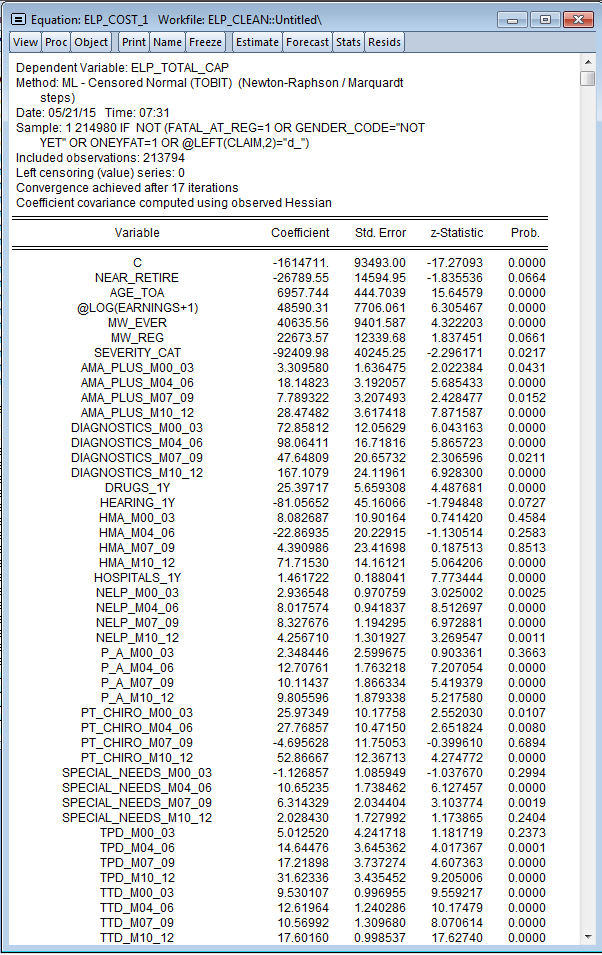

If it's not confidential, can you produce a picture of the representations view?
ian.e.preston
Posts: 21
Joined: Mon Feb 23, 2015 1:06 pm
Re: Tobit Forecast error
Postby ian.e.preston » Thu May 21, 2015 6:51 am
Sure, does this work?
Postby EViews Gareth » Thu May 21, 2015 8:00 am
Open your equation and click on View->Representations. That's the information we need.
ian.e.preston
Posts: 21
Postby ian.e.preston » Thu May 21, 2015 8:32 am
Estimation Command: ========================= CENSORED(D=N, L=0) ELP_TOTAL_CAP C NEAR_RETIRE @EXPAND(ACC_YEAR_CAT,@DROP(100)) AGE_TOA @LOG(EARNINGS+1) @EXPAND(GENDER_CODE,@DROP("F")) @EXPAND(MULTIPLE_CLAIMS,@DROP("N")) MW_EVER MW_REG @EXPAND(SECTOR,@DROP("Construction")) SEVERITY_CAT @EXPAND(NOI_IANCAT_T,@DROP("Other")) @EXPAND(POB_IANCAT_T,@DROP("Other")) @EXPAND(SOI_IANCAT,@DROP("Other")) AMA_PLUS_1Y_G DIAGNOSTICS_1Y_G DRUGS_1Y HEARING_1Y HMA_1Y_G HOSPITALS_1Y NELP_1Y_G P_A_1Y_G PT_CHIRO_1Y_G SPECIAL_NEEDS_1Y_G TPD_1Y_G TTD_1Y_G VR01_1Y_G VR02_1Y_G VR04_1Y VR_OTH_1Y_G VSC_1Y Estimation Equation: ========================= I_ELP_TOTAL_CA = C(1) + C(2)*NEAR_RETIRE + C(3)*AGE_TOA + C(4)*@LOG(EARNINGS+1) + C(5)*MW_EVER + C(6)*MW_REG + C(7)*SEVERITY_CAT + C(8)*AMA_PLUS_M00_03 + C(9)*AMA_PLUS_M04_06 + C(10)*AMA_PLUS_M07_09 + C(11)*AMA_PLUS_M10_12 + C(12)*DIAGNOSTICS_M00_03 + C(13)*DIAGNOSTICS_M04_06 + C(14)*DIAGNOSTICS_M07_09 + C(15)*DIAGNOSTICS_M10_12 + C(16)*DRUGS_1Y + C(17)*HEARING_1Y + C(18)*HMA_M00_03 + C(19)*HMA_M04_06 + C(20)*HMA_M07_09 + C(21)*HMA_M10_12 + C(22)*HOSPITALS_1Y + C(23)*NELP_M00_03 + C(24)*NELP_M04_06 + C(25)*NELP_M07_09 + C(26)*NELP_M10_12 + C(27)*P_A_M00_03 + C(28)*P_A_M04_06 + C(29)*P_A_M07_09 + C(30)*P_A_M10_12 + C(31)*PT_CHIRO_M00_03 + C(32)*PT_CHIRO_M04_06 + C(33)*PT_CHIRO_M07_09 + C(34)*PT_CHIRO_M10_12 + C(35)*SPECIAL_NEEDS_M00_03 + C(36)*SPECIAL_NEEDS_M04_06 + C(37)*SPECIAL_NEEDS_M07_09 + C(38)*SPECIAL_NEEDS_M10_12 + C(39)*TPD_M00_03 + C(40)*TPD_M04_06 + C(41)*TPD_M07_09 + C(42)*TPD_M10_12 + C(43)*TTD_M00_03 + C(44)*TTD_M04_06 + C(45)*TTD_M07_09 + C(46)*TTD_M10_12 + C(47)*VR01_M00_03 + C(48)*VR01_M04_06 + C(49)*VR01_M07_09 + C(50)*VR01_M10_12 + C(51)*VR02_M00_03 + C(52)*VR02_M04_06 + C(53)*VR02_M07_09 + C(54)*VR02_M10_12 + C(55)*VR04_1Y + C(56)*VR_OTH_M00_03 + C(57)*VR_OTH_M04_06 + C(58)*VR_OTH_M07_09 + C(59)*VR_OTH_M10_12 + C(60)*VSC_1Y + C(61)*(ACC_YEAR_CAT=2006) + C(62)*(ACC_YEAR_CAT=2007) + C(63)*(ACC_YEAR_CAT=2008) + C(64)*(ACC_YEAR_CAT=2009) + C(65)*(ACC_YEAR_CAT=2010) + C(66)*(ACC_YEAR_CAT=2011) + C(67)*(ACC_YEAR_CAT=2012) + C(68)*(GENDER_CODE="M") + C(69)*(MULTIPLE_CLAIMS="UNKNOWN") + C(70)*(MULTIPLE_CLAIMS="Y") + C(71)*(SECTOR="Agriculture & Forestry") + C(72)*(SECTOR="Bus, Pers, & Prof Srv") + C(73)*(SECTOR="Gov, Edu, & Hlth") + C(74)*(SECTOR="Mfg, Proc & Pckg") + C(75)*(SECTOR="Mining & Petroleum") + C(76)*(SECTOR="Prov") + C(77)*(SECTOR="Self-Insured, Oth WCBs, Misc Claim, Temp Class") + C(78)*(SECTOR="Trans, Comm & Util") + C(79)*(SECTOR="Wholesale & Retail") + C(80)*(NOI_IANCAT_T="Systemic Disease") + C(81)*(NOI_IANCAT_T="Trauma_bone") + C(82)*(NOI_IANCAT_T="Trauma_cran") + C(83)*(NOI_IANCAT_T="Trauma_muscle") + C(84)*(NOI_IANCAT_T="Trauma_oth") + C(85)*(NOI_IANCAT_T="Trauma_wound") + C(86)*(POB_IANCAT_T="Head") + C(87)*(POB_IANCAT_T="Lower Ext") + C(88)*(POB_IANCAT_T="Neck") + C(89)*(POB_IANCAT_T="Trunk_back") + C(90)*(POB_IANCAT_T="Trunk_chest") + C(91)*(POB_IANCAT_T="Trunk_oth") + C(92)*(POB_IANCAT_T="Trunk_shoulder") + C(93)*(POB_IANCAT_T="Upper Ext") + C(94)*(SOI_IANCAT="Chemical") + C(95)*(SOI_IANCAT="Container") + C(96)*(SOI_IANCAT="Furniture") + C(97)*(SOI_IANCAT="Machinery") + C(98)*(SOI_IANCAT="Part-Material") + C(99)*(SOI_IANCAT="Person-Plant-Animal-Minteral") + C(100)*(SOI_IANCAT="Structure-Surface") + C(101)*(SOI_IANCAT="Tool-Instrument-Equipment") + C(102)*(SOI_IANCAT="Vehicle") Forecasting Equation: ========================= I_ELP_TOTAL_CA = C(1) + C(2)*NEAR_RETIRE + C(3)*AGE_TOA + C(4)*@LOG(EARNINGS+1) + C(5)*MW_EVER + C(6)*MW_REG + C(7)*SEVERITY_CAT + C(8)*AMA_PLUS_M00_03 + C(9)*AMA_PLUS_M04_06 + C(10)*AMA_PLUS_M07_09 + C(11)*AMA_PLUS_M10_12 + C(12)*DIAGNOSTICS_M00_03 + C(13)*DIAGNOSTICS_M04_06 + C(14)*DIAGNOSTICS_M07_09 + C(15)*DIAGNOSTICS_M10_12 + C(16)*DRUGS_1Y + C(17)*HEARING_1Y + C(18)*HMA_M00_03 + C(19)*HMA_M04_06 + C(20)*HMA_M07_09 + C(21)*HMA_M10_12 + C(22)*HOSPITALS_1Y + C(23)*NELP_M00_03 + C(24)*NELP_M04_06 + C(25)*NELP_M07_09 + C(26)*NELP_M10_12 + C(27)*P_A_M00_03 + C(28)*P_A_M04_06 + C(29)*P_A_M07_09 + C(30)*P_A_M10_12 + C(31)*PT_CHIRO_M00_03 + C(32)*PT_CHIRO_M04_06 + C(33)*PT_CHIRO_M07_09 + C(34)*PT_CHIRO_M10_12 + C(35)*SPECIAL_NEEDS_M00_03 + C(36)*SPECIAL_NEEDS_M04_06 + C(37)*SPECIAL_NEEDS_M07_09 + C(38)*SPECIAL_NEEDS_M10_12 + C(39)*TPD_M00_03 + C(40)*TPD_M04_06 + C(41)*TPD_M07_09 + C(42)*TPD_M10_12 + C(43)*TTD_M00_03 + C(44)*TTD_M04_06 + C(45)*TTD_M07_09 + C(46)*TTD_M10_12 + C(47)*VR01_M00_03 + C(48)*VR01_M04_06 + C(49)*VR01_M07_09 + C(50)*VR01_M10_12 + C(51)*VR02_M00_03 + C(52)*VR02_M04_06 + C(53)*VR02_M07_09 + C(54)*VR02_M10_12 + C(55)*VR04_1Y + C(56)*VR_OTH_M00_03 + C(57)*VR_OTH_M04_06 + C(58)*VR_OTH_M07_09 + C(59)*VR_OTH_M10_12 + C(60)*VSC_1Y + C(61)*(ACC_YEAR_CAT=2006) + C(62)*(ACC_YEAR_CAT=2007) + C(63)*(ACC_YEAR_CAT=2008) + C(64)*(ACC_YEAR_CAT=2009) + C(65)*(ACC_YEAR_CAT=2010) + C(66)*(ACC_YEAR_CAT=2011) + C(67)*(ACC_YEAR_CAT=2012) + C(68)*(GENDER_CODE="M") + C(69)*(MULTIPLE_CLAIMS="UNKNOWN") + C(70)*(MULTIPLE_CLAIMS="Y") + C(71)*(SECTOR="Agriculture & Forestry") + C(72)*(SECTOR="Bus, Pers, & Prof Srv") + C(73)*(SECTOR="Gov, Edu, & Hlth") + C(74)*(SECTOR="Mfg, Proc & Pckg") + C(75)*(SECTOR="Mining & Petroleum") + C(76)*(SECTOR="Prov") + C(77)*(SECTOR="Self-Insured, Oth WCBs, Misc Claim, Temp Class") + C(78)*(SECTOR="Trans, Comm & Util") + C(79)*(SECTOR="Wholesale & Retail") + C(80)*(NOI_IANCAT_T="Systemic Disease") + C(81)*(NOI_IANCAT_T="Trauma_bone") + C(82)*(NOI_IANCAT_T="Trauma_cran") + C(83)*(NOI_IANCAT_T="Trauma_muscle") + C(84)*(NOI_IANCAT_T="Trauma_oth") + C(85)*(NOI_IANCAT_T="Trauma_wound") + C(86)*(POB_IANCAT_T="Head") + C(87)*(POB_IANCAT_T="Lower Ext") + C(88)*(POB_IANCAT_T="Neck") + C(89)*(POB_IANCAT_T="Trunk_back") + C(90)*(POB_IANCAT_T="Trunk_chest") + C(91)*(POB_IANCAT_T="Trunk_oth") + C(92)*(POB_IANCAT_T="Trunk_shoulder") + C(93)*(POB_IANCAT_T="Upper Ext") + C(94)*(SOI_IANCAT="Chemical") + C(95)*(SOI_IANCAT="Container") + C(96)*(SOI_IANCAT="Furniture") + C(97)*(SOI_IANCAT="Machinery") + C(98)*(SOI_IANCAT="Part-Material") + C(99)*(SOI_IANCAT="Person-Plant-Animal-Minteral") + C(100)*(SOI_IANCAT="Structure-Surface") + C(101)*(SOI_IANCAT="Tool-Instrument-Equipment") + C(102)*(SOI_IANCAT="Vehicle") ELP_TOTAL_CAP = 0*@CNORM((0 - I_ELP_TOTAL_CA)/C(103)) + (1-@CNORM((0 - I_ELP_TOTAL_CA)/C(103))>0)*(I_ELP_TOTAL_CA*(1-@CNORM((0 - I_ELP_TOTAL_CA)/C(103)))+C(103)*(@DNORM((0 - I_ELP_TOTAL_CA)/C(103)))) Substituted Coefficients: ========================= I_ELP_TOTAL_CA = -1614710.98065 - 26789.5530394*NEAR_RETIRE + 6957.74415121*AGE_TOA + 48590.3102126*@LOG(EARNINGS+1) + 40635.5642547*MW_EVER + 22673.5688848*MW_REG - 92409.9787925*SEVERITY_CAT + 3.30958033183*AMA_PLUS_M00_03 + 18.1482252985*AMA_PLUS_M04_06 + 7.7893220426*AMA_PLUS_M07_09 + 28.4748167969*AMA_PLUS_M10_12 + 72.8581174228*DIAGNOSTICS_M00_03 + 98.0641095925*DIAGNOSTICS_M04_06 + 47.6480910912*DIAGNOSTICS_M07_09 + 167.107923955*DIAGNOSTICS_M10_12 + 25.3971707172*DRUGS_1Y - 81.0565197441*HEARING_1Y + 8.08268741174*HMA_M00_03 - 22.8693450601*HMA_M04_06 + 4.39098628697*HMA_M07_09 + 71.7153004096*HMA_M10_12 + 1.46172245252*HOSPITALS_1Y + 2.93654832849*NELP_M00_03 + 8.01757385383*NELP_M04_06 + 8.3276759079*NELP_M07_09 + 4.256710017*NELP_M10_12 + 2.34844559079*P_A_M00_03 + 12.7076082919*P_A_M04_06 + 10.1143698038*P_A_M07_09 + 9.80559570228*P_A_M10_12 + 25.9734909709*PT_CHIRO_M00_03 + 27.768574888*PT_CHIRO_M04_06 - 4.69562787031*PT_CHIRO_M07_09 + 52.8666677923*PT_CHIRO_M10_12 - 1.12685708913*SPECIAL_NEEDS_M00_03 + 10.6523493799*SPECIAL_NEEDS_M04_06 + 6.31432883308*SPECIAL_NEEDS_M07_09 + 2.02842969604*SPECIAL_NEEDS_M10_12 + 5.01252030069*TPD_M00_03 + 14.6447576257*TPD_M04_06 + 17.2189782895*TPD_M07_09 + 31.623360628*TPD_M10_12 + 9.53010743679*TTD_M00_03 + 12.6196426568*TTD_M04_06 + 10.5699200352*TTD_M07_09 + 17.6016034446*TTD_M10_12 + 15.6129449199*VR01_M00_03 + 21.5224459081*VR01_M04_06 + 23.6770971921*VR01_M07_09 + 41.0159588494*VR01_M10_12 - 12.1478646249*VR02_M00_03 + 8.262673884*VR02_M04_06 + 4.59013830089*VR02_M07_09 + 19.7543303331*VR02_M10_12 + 28.2245777518*VR04_1Y + 15.3559915624*VR_OTH_M00_03 + 12.3849878504*VR_OTH_M04_06 + 4.6052073706*VR_OTH_M07_09 + 4.28998113708*VR_OTH_M10_12 + 3.91405997335*VSC_1Y - 84327.9485296*(ACC_YEAR_CAT=2006) - 90754.0103886*(ACC_YEAR_CAT=2007) - 112812.492508*(ACC_YEAR_CAT=2008) - 160667.435539*(ACC_YEAR_CAT=2009) - 204292.776148*(ACC_YEAR_CAT=2010) - 268039.661526*(ACC_YEAR_CAT=2011) - 336892.014279*(ACC_YEAR_CAT=2012) - 26588.6576571*(GENDER_CODE="M") - 82596.3601714*(MULTIPLE_CLAIMS="UNKNOWN") + 17773.5953263*(MULTIPLE_CLAIMS="Y") - 47702.6837375*(SECTOR="Agriculture & Forestry") - 40159.2101544*(SECTOR="Bus, Pers, & Prof Srv") - 78737.2808991*(SECTOR="Gov, Edu, & Hlth") + 31694.789773*(SECTOR="Mfg, Proc & Pckg") + 23894.8306953*(SECTOR="Mining & Petroleum") - 85589.078792*(SECTOR="Prov") + 7842.64724103*(SECTOR="Self-Insured, Oth WCBs, Misc Claim, Temp Class") - 44925.9333435*(SECTOR="Trans, Comm & Util") - 41044.2234382*(SECTOR="Wholesale & Retail") - 39560.7004262*(NOI_IANCAT_T="Systemic Disease") - 125797.279309*(NOI_IANCAT_T="Trauma_bone") - 171592.986912*(NOI_IANCAT_T="Trauma_cran") - 122751.782997*(NOI_IANCAT_T="Trauma_muscle") - 119384.547665*(NOI_IANCAT_T="Trauma_oth") - 167261.231562*(NOI_IANCAT_T="Trauma_wound") - 5520.68117683*(POB_IANCAT_T="Head") - 5957.58718901*(POB_IANCAT_T="Lower Ext") + 20734.5516747*(POB_IANCAT_T="Neck") + 21733.1561062*(POB_IANCAT_T="Trunk_back") + 56183.3076002*(POB_IANCAT_T="Trunk_chest") - 51982.9554993*(POB_IANCAT_T="Trunk_oth") + 35951.9793047*(POB_IANCAT_T="Trunk_shoulder") + 40623.9025504*(POB_IANCAT_T="Upper Ext") + 63603.5054665*(SOI_IANCAT="Chemical") - 49275.4115523*(SOI_IANCAT="Container") - 49134.9548235*(SOI_IANCAT="Furniture") - 28137.9802417*(SOI_IANCAT="Machinery") - 19204.9967132*(SOI_IANCAT="Part-Material") - 5124.86723758*(SOI_IANCAT="Person-Plant-Animal-Minteral") - 35599.6578216*(SOI_IANCAT="Structure-Surface") - 54214.5643318*(SOI_IANCAT="Tool-Instrument-Equipment") - 47208.6811414*(SOI_IANCAT="Vehicle") ELP_TOTAL_CAP = 0*@CNORM((0 - I_ELP_TOTAL_CA)/372644.142433) + (1-@CNORM((0 - I_ELP_TOTAL_CA)/372644.142433)>0)*(I_ELP_TOTAL_CA*(1-@CNORM((0 - I_ELP_TOTAL_CA)/372644.142433))+372644.142433*(@DNORM((0 - I_ELP_TOTAL_CA)/372644.142433)))
