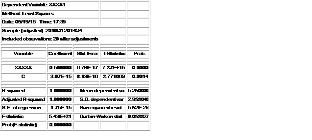

I thought it was odd too (EViews states explicitly in its help material, that "If there is no such restrictions, this method is identical to estimating each equation using single-equation ols." - see "System Estimation Methos OLS").
However, it yields different results even if you have only a singe equation. You can try it with an arbitrary example:
That's the output for an usual equation:
Example ordinarily stated 1.png (13.4 KiB) Viewed 7996 times
That's for the usual equation to show that there is something differently estimated (compare to the one stated as system)
Example ordinarily stated 2.png.gif (6.58 KiB) Viewed 7996 times
Arbeitsmappe1.xlsx
That are the numbers used in the example:
(8.63 KiB) Downloaded 547 times

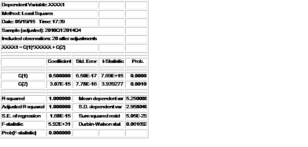

My other posts showing the same numberes done by OLS again burt stated as system:
Example stated as system 1.png (13.99 KiB) Viewed 7995 times
Example stated as system 2.png.gif (5.87 KiB) Viewed 7995 times
so, am I doing something wrong - mistake - what is going on?
Thanks for replying!

Your results are identical except for rounding error. Note the RSqr = 1, so the standard errors are effectively all zero.
