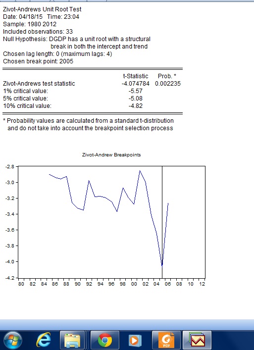

Can someone help me in interpreting the Zivot Andrews test result? I am attaching here the screenshot of the result.

Accounting for the breakpoint estimation, the p-value for rejecting the null is in excess of 0.10.

Dear Glenn,
the t-statistic suggests that we should not reject the null, while the p-val indicates we should reject the null.
Why are these contradicting?

As the note indicates, the reported p-value in this case does not account for the breakpoint selection process. Use the critical values.
