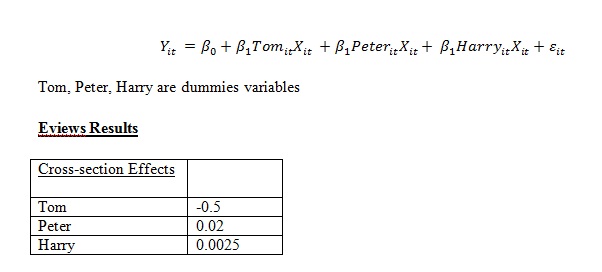

I have got regressions results generated using Eviews. It has "Cross-Section Effects". However I seldom use Eviews, and would like to know what "Cross-Section Effects" is. Is it the co-efficients on the dummies? If yes, 1 of the dummies should have been dropped due to multicollinearity. But I note the model has interaction terms between the dummies and the regressor.
Refer to attachment for details.
How do I generate "Cross-Section Effects" in Eviews?

They are cross-section deviations from the overall intercept mean. Which is one method of interpreting fixed effects.

If you think about having a dummy variable for each cross-section, take the mean value of the coefficients on the dummy variables, then take each coefficient's difference from that mean. That is what is shown.

You can estimate an equation with no constant and a full set of dummies (i.e. you don't need to drop a dummy if you have dropped the constant). If you do that, you can then take the mean of the dummy coefficients, and call that the constant. You can then show the difference between each dummy coefficient and their mean.

In the attachment of my 1st post, there are the values of the cross-section effect for each of the dummy variables. Since this table was given to me, I have no idea how to obtain the "values of the cross-section effect for each of the dummy variables" in Stata.
I have figured it out in Eviews: View → Fixed/Random effects - > Cross-section effects.
