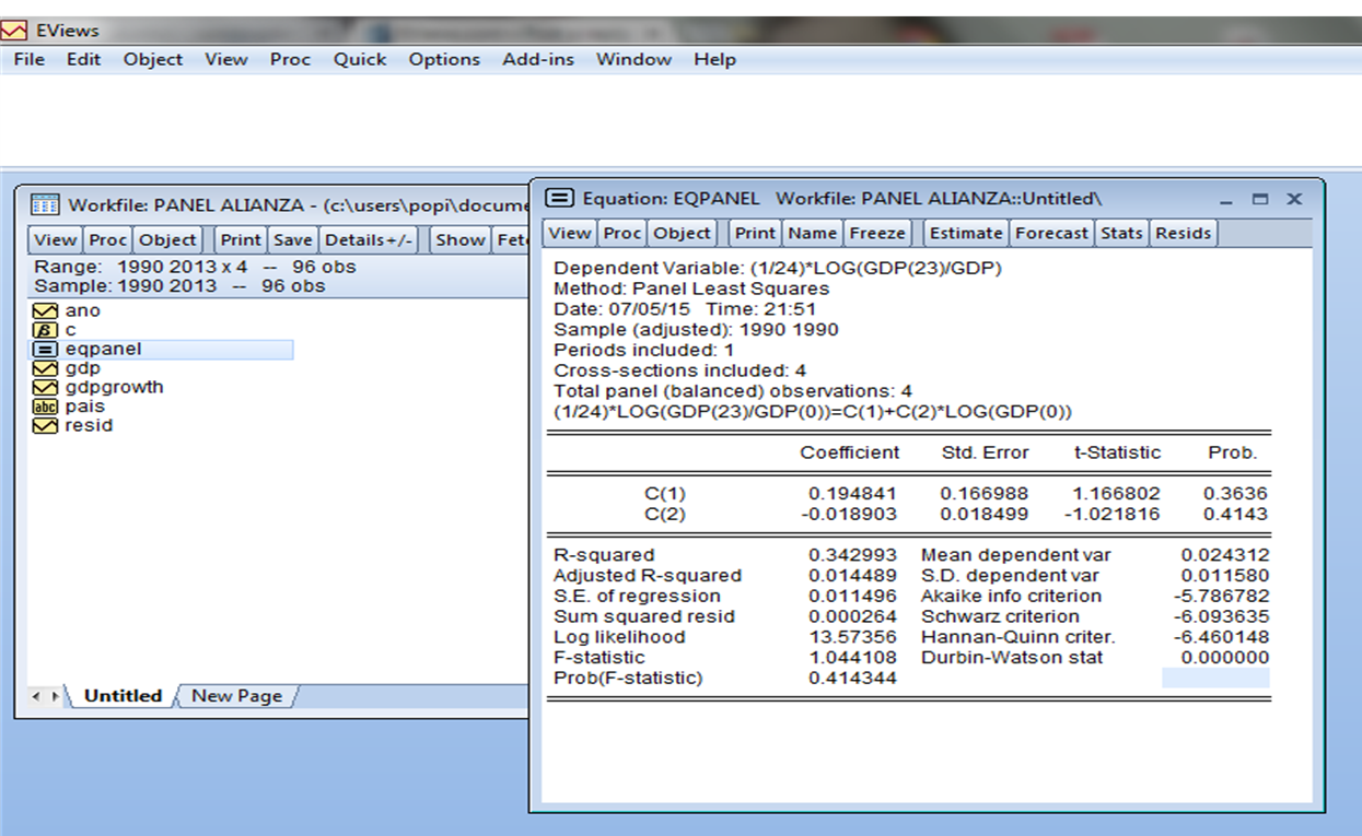

Thanks, I already set my panel regression getting the results in the attachment the thing is that the coeficients are not significant and I wanted to try the fixed effects metod, getting the error "Near Singular Matrix".
- Imagen1.png (409.35 KiB) Viewed 11512 times
- Posts: 3798
Re: Economic convergence model
You are only using 4 observations. That's probably not what you want.
Yes the thing is that those are the only four countries I need to study, later i will introduce more countries (but not more than 20) is there a way to make this result more robust? thank you.
- Posts: 3798
You can't used fixed effects if you only have one observation per country.
So I guess I have to change the model but that means that I could not apply or test the convergence theory in the basic form wich says that average gdp growth depends on the inicial gdp. or use other methods.
- Posts: 3798
Right. Or at least it says you can't use fixed effects, which don't make any sense here anyway.
