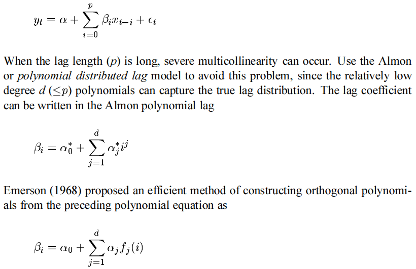

I have to know if eviews has any commands that compute or deal with PDL's. I noticed in other packages it goes by PDLREG, I didn't see that in the command list for eviews, but maybe it goes by a different name?
Alternatively, what would be even better is if I could code a new series to include in my LS regression. This way I can have my contemporaneous xj and a corresponding xj that is computed by one of the following operations (either the Almon or the Emerson):
Polynomial Distributed Lag.png (53.54 KiB) Viewed 13955 times

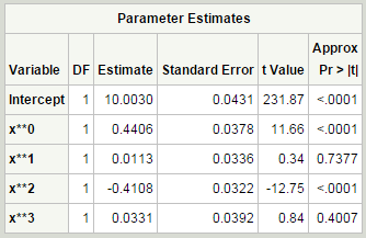

Just when I thought I cleared up the confusion, I'm mistaken. I didnt mean the Polynomial Fit, I just meant to find a good fit for the PDL degree.
So I have read through the entire PDL procedure on the EViews Guide, and read as much about the eviews way on other websites.
I have then condensed my query to three simple questions below.
1. How does one go about determining the degree of a PDL in Eviews?
Consider this table that is computed after running a PDL from a similar package:
Polynomial Order.png (25.75 KiB) Viewed 13874 times
We can test whether a degree is suitable or not by seeing which degree (of the polynomial) is significant. In the above example, a quadratic would do well.
that was what I meant by my earlier attempt to code a similar diagnostic regression -- just to reproduce something as in the above table.
2. Eviews guide points out that tests on significance are computed using the polynomial term gamma coefficients, if there is nothing built in for p values, how does eviews test for nulls for the betas? The t stat is provided, but what k (including beta in k?) to use when looking up the distribution?
3. Also is it possible to retrieve the polynomial formula? I want to reproduce it and plot it.
Again, sorry for the confusion, this time I have thought out my questions for a very long time, so as not to waste any more of your time.
